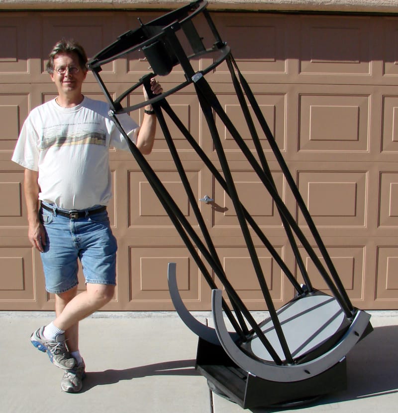

One of the nicest 20's I've seen is a collapsible unit, sort of like a Chinese finger-trap, the secondary and spider get collapsed down to the primary for transport and extended for use. The best part though is that the scope is all open when setup so it reaches thermal equilibrium very quickly. It's also part the value of all truss based scopes these days:
Might be a little scary but you might consider laser cutting a honeycomb pattern out of the barrel of the scope for the same reason. Having a few hours more of viewing time each night would probably be very nice.

That 20" is a lovely scope, and is the type and size I will eventually build. Is it yours?
I have been doing astronomy for over 40 years now, with many scopes previously only up to 10" in size. I'm currently doing various mods on the new 14" which has not yet seen first light. This is the model I have...
With so much light pollution here in the UK, I will be using a fabric light shroud around the open truss. Over here we tend to have smaller cars than you in the states, and therefore, in general, smaller scopes :)

As for that 20 above, no, it's just a scope (17?) picture to illustrate the "open truss" style. It's not the really cool collapsing 20 I described. I can't find a picture of it. That one's structure had about 60 pieces so it could fold down. I had a 17 inch Dobsonian until recently. It was a mammoth pain in the butt to use. The tube alone weighed 105 pounds without the mirror. Then the base was another 140lbs and large and ungainly foot crusher. Couple those issues with living in the absolute worst town on earth for star gazing and that meant I always had to load my scope up into, no less than a truck, and lug it up somewhere that could also be shrouded in fog. I finally broke it down keeping the spider, primary, secondary, and eye piece with the vague hope of building a collapsible or at least a truss scope so I don't HAVE to have someone go with me just to help with lifting.
Yes a shroud around light is needed. Truss scopes also have a little less contrast since any off axis light tends to cause that. A shroud that can absorb any and block is a great idea - after the scope is at ambient. :)
