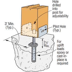

Just because there was a post there doesn't mean that there always has to be one there. It sounds as if the fence is getting rebuilt in the vicinity of the rotted post, so a slighly different post location probably won't be noticable. Probably don't need to be too concerned with seismic load on a fence but you might need to assess the wind load.
Fill the old hole with masonry plug of some variety and set a Simpson bracket of some other sort in a new, nearby hole.
http://www.strongtie.com/products/connectors/EPB44...

My thought was that a hole would be drilled in the existing continuous footing and an anchor epoxied in place. There are various Simpson products available which may prove suitable, or unsuitable - caveat emptor.
