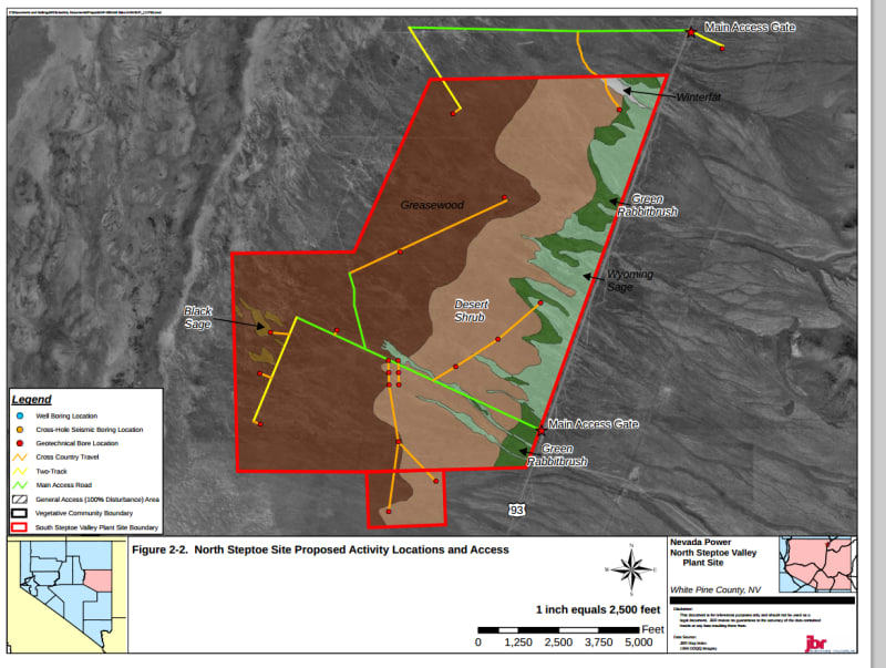

We simply want to enable the geologist in the office, or in the field, to write down the borings he/she decides in an easy to understand format, re-usable and updatable across the project. An example:
How do you layout the borings now? It could be as simple as putting marks with the pen on a printed map.
Do you consider that activity or related ones cumbersome, or are there much more important areas that you'd rather see improved?
RE: Borehole planning
We typically just layout borings using a printed plan or map of the area. I usually use coins until I get the number and locations about right, then marking them with a pen.
