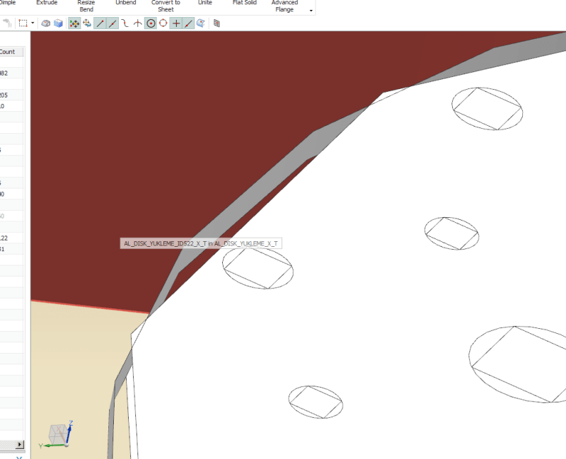

Hello everyone,
i have a problem with my nx 9.
With nx 8.5 i didn't have this problem.
On my working part, All holes, fillet edges looks like that.
On my notebook it's same.
I've quadro FX4800 , quadro k5000m.
How can i solve my problem?

Have you open the assembly in lightwegt mode ?
If yes, it's normal, but with some setting you can view better using a new setting added in NX9.

Nope, i never use lightweight assmbly mode.

Take a look at Fundamentals - Display facet enhancements in the What's New Guide.
There are some new preferances for how the facets are displayed, based on the view or the part.

I suppress the sub-assamblies that i rarely use.
I didn't have performance problems yet. If i have problems on performance in future, i may use.

i still couldn't solve my problem.
There are hundreds of settings about "facet".
If i try all of them it'll take hours.
Am i only the one who has this problem?

If you have access to Siemens GTAC via a webkey account, there is a document that explains what you want.
Search for "Improving Edge Display Quality In The Graphics Display".

i solved my problem with this way.

so you changed the resolution ?
RE: NX 9.0 problem of viewing edges
yes...
