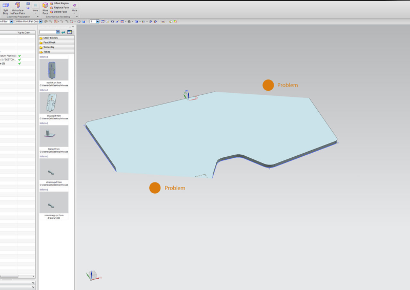

I just started to learn Siemens NX and im having a problem. When I make a part and Im rotating it to have a look it partly disappear (the edges). It should not be due to my graphic card, couse its a very good one. I red somewhere I had to go Preferences - Visualization performance - and under "Large model" I should uncheck "Fixed frame rate". This doesn't do the trick for me. Hope anyone can be so kind to help me out here.

You are rotating beyond the current view extents, fit the model and this will behave as expected

Thank you for your fast reply. Can you please tell me where to find where to adjust this? Was looking at Menu - tools - Vehicle Design Automation - Vision model - Direct field of view. But this didn't make me much smarter im afraid :( is there a specific place to punch in some numbers, or is it a box to check /uncheck?

View -> operation -> fit
Or, if you like keyboard shortcuts:
Ctrl + F

Thank you 1000 times! You are the best :)
