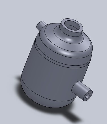

Hi, I'm not well versed in blow molding. I need to make a container in the shape of the following pictures.
Essentially, it's just a regular bottle, but with two openings (protrusions) on the side, for connecting to tubes.
Can it even be manufactured? How can the protrusions on the side be manufactured? I talked to a maker of conventional bottles and they said they "don't have the machines to make the protrusions on the side."

You can't blow nipples out of the sides of a bottle, where e.g. the wall of a milk bottle is super thin.
You _can_ blow multiple necks in a bottle. The trick is to make the mold so that the neck portion just above the bottle has two or three lumens. ... which rejoin each other above that, into a single neck that can be blown on most any machine. Then the neck trim operation cuts off the waste above the multiple necks.
It's sort of like blowing an integral handle at the top of a big jug, with the trim line through the handle, not above it. Of course the necks must share the same parting plane.

here is the picture:
http://s4.postimg.org/f8k9n91l7/bottle1.jpg
If you can't see it, then try here:
https://www.flickr.com/photos/124719011@N02/140127...
https://www.flickr.com/photos/124719011@N02/141993...
Let me know if there are any additional insights now that you've seen the pics. The two protrusions are on opposite sides of each other.

You could rotationally mold that part, if you aren't too picky about tolerances.

In your case, the extra nipples would have to be parallel to the neck on the top, generally parallel to it, and close enough together so that their outer walls lie inside the extruded parison.

Possibly blow-molded, as long as all the openings are on the parting line and you're not picky about wall thickness.
RE: can a plastic container of this shape be manufactured?
"Connecting to tubes" suggests the OP will eventually need to be picky about wall thickness, whether (s)he realizes that now or not.
Pulling a nipple with reasonable wall thickness out of what is already the thinnest part of a bottle is not possible.
With rotational molding, yes, it's possible, but the cycle time will make it an expensive part, relative to blow molding.

Thanks for the help guys.
So in conclusion. The part can most likely be made with rotational molding, though it might be expensive. (I'm not too concerned with tolerances).
With blow molding, it's hard to get a decent wall thickness for the nipples, so it will most likely not work.

1) The container holds roughly 5ml of fluid, with a diameter of 20mm and height of 25mm roughly. It's small part.
2. I want to use PE or LDPE for material
3. Wall thickness for the bottle should be 1mm roughly. I can accept a lower thickness for the nipples if they can blow mold it. The nipples are to be mated to silicone tubing. I think I can make the nipples larger and just insert the tubing inside the nipple, rather than the other way around. This way, a thin wall will not cause problems. The system will not be subject to any significant pressure. As long as it doesn't leak, it'll be acceptable.
4. Probably will want to make 1000 at a time.
5. This shape is the most desirable because of the special application.

Ah. Given that the part is that small, I'll accept that the part can be blow molded, in a relatively large machine. You can just blow the side nipples out of the parison.
I'd suggest also molding barbs or beads in the nipples, and pushing the silicone tubing over them. Allow some length so you can shrink some shrinktube over the assembled hoses if need be.

Actually, that's kind of how blow molding works.
The machine produces, by extrusion, sheet in the form of a tube called a parison, which may or may not be round. Then the mold closes over the tube, pinching and sealing the end and the periphery, and compressed gas injected through the center of the extrusion nozzle inflates the product. The mold opens after the product has cooled a bit, and it's sent on to have the ends and flash trimmed off.
