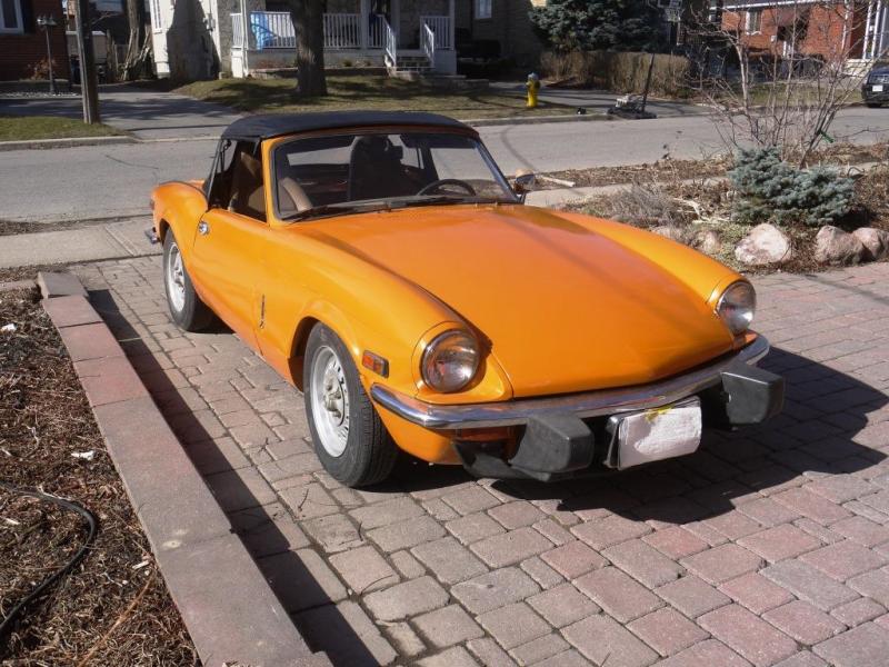

I've owned a 1975 Triumph Spitfire since the late '80s when I was in uni and wanted to learn about cars from my dad, a long-retired auto and diesel mechanic. Oh, and it taught me, the hard way- the Leyland 1500 engine was an utter piece of crap, disappointing me numerous times. I put a Toyota 20R engine and transmission in it in the early '90s, but it never really fit the car. The last sticker on the license plate was the year I moved in with the girl who DIDN'T like this car- we've been married now for 15 years. I kept the car though, with the intention to do something fun with it some day.
My son is 11- old enough to be useful (when he can be pried away from video games), but young enough to still think what his dad does is worth paying attention to. So the two of us have embarked on an electric conversion of the Spitfire. Goal is a daily driver for my commute in the spring, fall, and days in the summer where the lack of A/C won't roast me to death. 60 km one way, with a charge at work to get home.
Current status is that we've pulled the engine, exhaust system, gas tank etc., separated the body from the frame, restored the frame (lots of practice welding!), painted it with surface tolerant epoxy, replaced the brake lines and hoses, and ordered the parts for the conversion. Body is going to take quite a bit of work- floor pans, rocker panels etc.
Going with an AC system- a HPEV AC50 motor and Curtis controller, and LiFePO4 prismatic cell battery pack. I've seen lots of conversions done using this system including this one, which used an AC51 (just a higher voltage version of the AC50):

RE: Electric Car Conversion
Very orange, complete with orange peel...Topaz orange, which is an original Spitfire and TR6 colour but comparatively rare on the cars that are left. But no runs or sags, and only a few bits of nastiness embedded in the finish, so it should wet sand and polish up nicely!
Very glad this bodywork is more or less behind me- from this point onward, parts should be going back onto the car!

Update: car is DONE, or at least done enough that I'll take it soon for a safety inspection. Assuming the guy is reasonable with me, and I can find an insurer who isn't scared off, it should be legally on the road in the next month or so.
You have arrived in style!

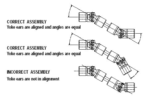

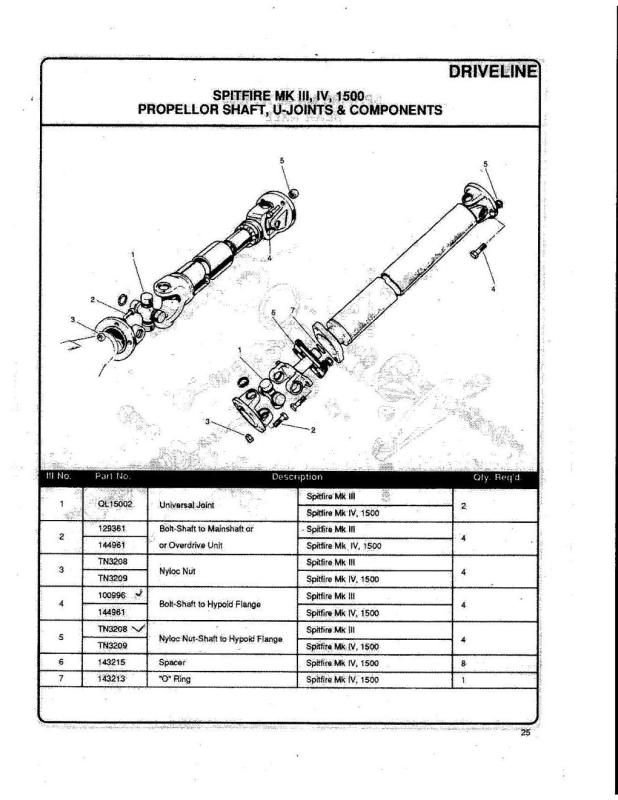

Great news is that the new diff seems to have good oil seals.
Bad news is that apparently my dad and I didn't fully understand the design of the Leyland driveshaft...when we swapped in the Toyota motor and tranny, we cut the Toyota driveshaft off at the tranny end, keeping its U joint- and we chopped the front U joint off the Leyland driveshaft, machined both pieces in the lathe, fit them together and even welded them in the lathe- perfect. Only one wee problem, or at least it seems that way from what I understand now. The Toyota transmission has a sliding joint between the front U joint and the tranny- a splined collar slides in and out of the transmission to provide some axial "give" in the assembly, which is really handy for giving clearance for work on the drivetrain. But the Leyland driveshaft has an arrangement of flat strips of spring steel between the rear 2-bolt flange of the driveshaft and the front 2-bolt flange of the rear U joint, which I think were intended to serve the same purpose- not much axial give is required in the Spitfire because both the tranny and diff are fixed to the frame with rubber mounts and the rear wheels are independently suspended, and I guess this was a cheap and probably pretty reliable way to provide it.
Each 2-bolt flange bolts to diagonal corners of a square formed by two straps, and there are two layers of straps for a total of eight.
At least one of those spring-steel straps is cracked through and, I hope, that's the source of a new noise I hear whenever I take my foot off the accelerator and the motor goes into regenerative braking.
New straps are on order, from Spitbits in California (my wallet is stinging from the importation charges already), but I'm thinking I should make some thicker ones out of say 1/8" thick mild steel plate and make the assembly more rigid and resistant to the sudden torque reversals. I'd need longer bolts, and would want those pieces to be identical so the assembly stays balanced- but that should be about it. Having the driveshaft free to move axially at both ends is bound to be hard on the U joints over time.

I'm surprised to see this in a Spitfire tranny.
If this was a helicopter, I'd call it a "Kaflex" coupling.
Since the spitfire already has a set of U-joints and a spline, I'm not absolutely certain what the Kaflex joint is in there for, either. Does the body of the car flex so much that later models of car needed extra flex built into the transmission?
Umm, I think it's item #6 on your parts list scan, right? Does that diagram show parts from only one car, or is it two configurations from two different cars, in the same diagram? Is there an intermediate hanger bearing, not shown?
So it must be overlapping metal straps, drilled on the ends, the combination of which in a square makes a coupling between two bolts on one fitting to two bolts on the other fitting. I guess we can ignore, for the moment, there there already are 3 things in your tranny that are supposed to do the same thing as the Kaflex. The fact that the Kaflex is broken is proof, in a strange way, that it was actually doing something. The bars cracked because they were already subjected to excessive misalignment (or maybe the spline's freedom of motion bottoms out?). Replacing the bars with something thicker will change the allowable misalignment and displacement equation. Replacing them with something softer will change the stress equation. Neither in your favour.
STF

Waross, I think the answer is yes to all your points.
Yes the picture shows two different versions of the same driveshaft from different model year Spitfires. Mine is the one with the square part 6 which consists of eight 0.030" thick spring steel straps stacked up, which connect the 2 bolt flange on the driveshaft to the 2 bolt flange on the differential end u joint. In that design, in the original Spitfire 1500, the flange bolting the front u joint to the transmission is solid, with no splined joint.
The transmission and differential are both bolted to the frame with rubber shock mounts. My electric motor holds the front of the transmission more or less rigid, with very limited rubber slop- I did not reuse the original engine mounts- my motor mount is much more solidly connected to the frame as it doesn't dance around like an IC engine does.
The axial flex provided by the straps was presumably there to compensate for small amounts of axial movement of either part within the perhaps 1/4" of total relative movement in the axial direction afforded by the tranny and diff rubber mounts, plus any frame flex etc. The u joints themselves should take care of axial misalignment- all the straps handle in the Spitfire is any motion requiring the shaft to be a minor amount longer or shorter.
My version of this assembly has a splined joint at the front connection between the transmission and the front u joint, which should accomplish the same thing, only more reliably. A splined joint like that was used both on earlier and later model year Spitfirss.
It seems obvious even to a chemical engineer that you don't want axial flex at both ends of a shaft with two u joints. The tendency for the assembly to squirm like a rubber band being twisted would seem to be a major problem under large torques. You want a thrust bearing at one end of the assembly- in my case that would be the front bearing in the differential, which no doubt wasn't designed for much thrust, but should be able to handle at least some.
So my thicker straps are intended to make the rear joint axially rigid, or at least more rigid than it was. As close to a solid 4 bolt circular flanged joint like the one between the rear u joint and differential as I can manage.
Since there's a splined joint at the front which won't permit the assembly to push on my new straps in the axial direction with a force greater than the friction in that splined joint plus the inertia of the shaft, it's tough for me to see what force would be cycling my new straps to the point of fatigue. I know that a little force through millions of cycles can be enough, and I know they're not made of a springy material, but the material they are made of is greatly thicker so it should be stiffer and should not allow much strain. The stack of straps is about as thick as each two bolt flange at each bolting face, and those flange/yokes aren't made of spring steel either.
I put the initial failure down to the material being forty years old, and the assembly being free to squirm. Obviously we should have eliminated this flex joint when we made the new shortened driveshaft in 1992, but changing it now would be a huge effort. I could be wrong of course- maybe those straps will fatigue, or worse still, the yokes will fatigue. If my new straps don't last long, I will replace them with the set of spring steel replacements I have on order. This is relatively easy to work on and inspect from under the car- and it does seem to get noisy enough as a warning that I'm not worried about a sudden failure. And right now it's silent, which is a good sign.
If this drawing is correct, I thought I had the top geometry- or close enough to it.
Mike felt that the middle geometry was likely what the Spitfire had originally (did I get that right Mike?)
I have the bottom geometry- and therefore I guess a problem with cyclic loading on the driveshaft. If I were to bolt the two 2bolt flanges together without straps, the yoke ears fixed to the driveshaft at each end would be aligned, as shown in the Triumph parts drawing and the top picture in the image above- but with the straps in place, the ears are rotated by 90 degrees to one another.
Impressive that the assembly as it stands is actually working without giving me excessive vibration- or maybe i'm just used to vibration...
D'oh...just re read Mike's excellent post for about the fifth time...so the image I posted is apparently incorrect, as the middle geometry has angles of the same sign and the top geometry has angles of opposite sign. So I have a crossed shaft, totally by fluke, which if I understand Mike correctly, is actually what I want in this case- assuming my transmission is more or less level and the pinion shaft is similarly level.
Mike, please correct me if I'm wrong, again...!
In that illustration, the top image is wrong, the other two are both correct.
It appears that Mike is right, and this is widely misunderstood! But I think I understand Mike's point, and why the bottom drawing of that figure from a 4x4 site I found, which is as close to my geometry as possible (with the straps in the assembly), is actually correct rather than incorrect. It seems logical that the oscillations would be opposite for a given joint arrangement depending on whether both joints angle in the same direction or in opposite directions from the main shaft- angles of the same sign or opposite signs about the central axis of the shaft to put it the way Mike did. Similarly it seems logical that by arranging the joints at 90 degrees to one another the oscillations would be minimized.
I wonder if someone has a motion model of these somewhere so you can play with the angles and see the results!
I certainly didn't know this, and I'm sure my Dad didn't either. But I'm surprised that he didn't match the orientation that the Spitfire shaft had before we cut it- that he set the yokes 90 degrees apart was a fluke I'm sure. I have no idea what the orientation of the Toyota's shaft was originally.
Mike, even though it appears that blind luck won for me in this case, you deserve more LPS than I can award for clearing this up for me. Thanks a lot!

LionelHutz said "Well, the output u-joint is already turned 90* compared to the input u-joint when the drive shaft has both yokes in line."
Is that right? Irrespective of the angles of the joints relative to the driveshaft axis? Damn, I'm having a very hard time getting my head around this moving geometry to understand who is right here! I wish I had a simple double Cardan joint here that I could play with, bending it in the two configurations and spinning it to observe the output shaft rotation!

When looking at the complete shaft, the input yoke is the front yoke. So, the input yoke of the front joint is the one attached to the transmission. The input yoke of the rear joint is the one attached to the drive shaft. So, yes when the input yokes are turned 90*, the yokes on the drive shaft are inline with each other.
Here, watch this video.
https://www.youtube.com/watch?v=gmV4qwLfOMY
LionelHutz, thank you for your persistence.
I don't know where I got the idea that crossed yokes were useful or advisable, but it appears that I was completely wrong about that.
To summarize, the illustration is correct as shown, and I have had some brain fade.
