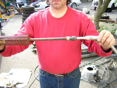

In case you actually want to do this I did some research a while back and unless you have access to that pyrolysis oven like the wrc guys this is likely the next best thing for mere humans.
http://www.rallyanarchy.com/phorum/read.php?5,6465
It's used to fog liquid nitrogen, you freeze all the undercoat and filler then chip it out. I've never used this myself but I have used dry ice and the difference between this method and solvents and scraping is unbelievable. If you are doing an entire car at strange angles dry ice would be tricky to use effectively and you use it up much more quickly than you might expect.
RE: What are the benefits to seam stitch welding for a tarmac rally car
With the dry ice on odd angles, I crush the dry ice in a bucket and make a slurry by adding isopropyl alcohol. Significantly better results, but decreased working time.
