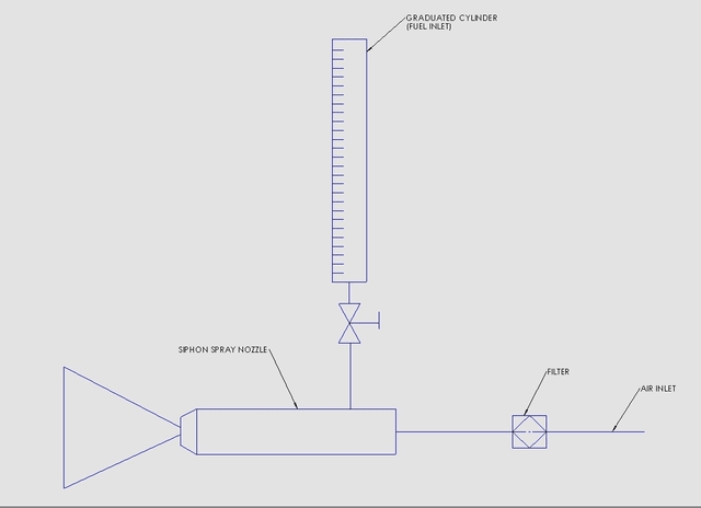

I apologize for not making this topic clear. Allow me to give some background. The purpose of this experiment is to measure and analyze the flow rate an oil burner spray nozzle called Siphon Air Atomizing Nozzles. The setup for this experiment is shown in this figure
The calculation of flow rate can be done. However, there are many losses in the fuel delivery system.
So far, the way we measure the flow rate of diesel fuel is to use stopwatch and graduated cylinder with valve. This step-up gives pretty good indication of the flow rate but not precise enough. See Figure below

sorry about that please see the picture below:
Current setup:

Generally, when volumetric measurements are too imprecise, laboratory folks use weight instead. But first, I'd try a graduated cylinder with a smaller diameter.
RE: Flow Measurement of Diesel Fuel
Don't try to calculate that. Too many imprecisely defined parameters, filter pressure drops, control valve Cv's, nozzle losses. Calculations do have their limitations. Conduct experimental measurements, if you don't want to waste your time and lose your mind in the process.

I was thinking to replace the graduated cylinder with a glass tube and a Totalizer. In my opinion, it's more accurate than a stop watch and an eye-measurement. I am not sure what you guys think of that.

Since this is a mixing nozzle feeding an air-diesel mixture to a burner, I'd imagine that measuring the mass flows of air and diesel are of more concern than measuring volume flows. The easiest way to measure mass flow of the liquid diesel is simply to use a scale to measure the change in weight of the fuel tank over a fixed period of operation at constant conditions.

The type of graduated cylinder that you would be looking to use is called a burette.
http://en.wikipedia.org/wiki/Burette
The level change will will cause a flow rate change. The be accurate you need to move the burette up as the level falls, or use the burette to feed the equivalent of a carburetor float bowl.

Right now we are using burette to measure the flow rate of the fuel, but once again, since it's controlled by an operator who controls the valve and stopwatch, plus with the error of measurement (eye-measuring). That's why we are looking for alternative method to measure the flow, more digital or data-recorder type.
