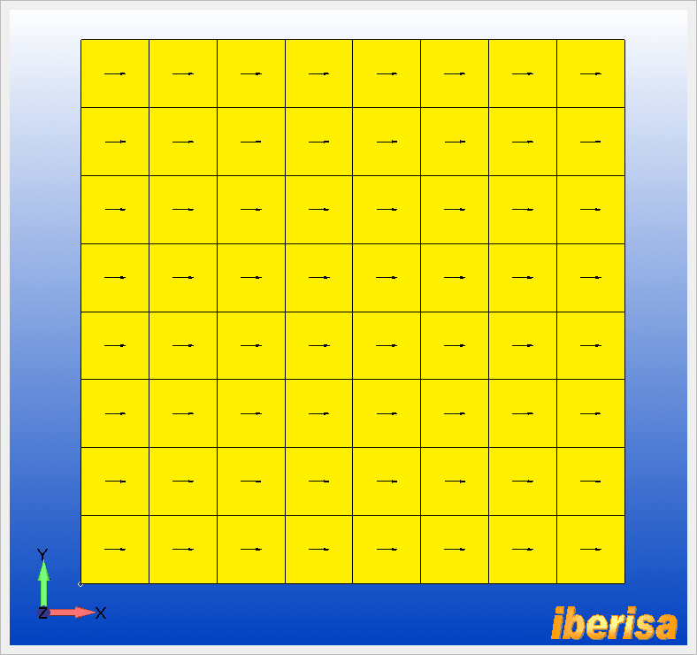

For laminate elements, you need to define a material direction,even if you are using an isotropic material. Go to the Modify/Update Elements/Material Orientation and set for all elements that use laminate property.

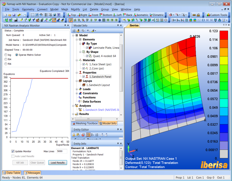

Here you are a tutorial explaining step-by-step how to create a 2-D composite model in FEMAP with orthotropic material properties:
http://www.iberisa.com/soporte/femap/composites/na...
You can learn how to define the material orientation:
And postprocess results:

My model worked!
Thank you BlasMolero, your tutorial was very helpful!
