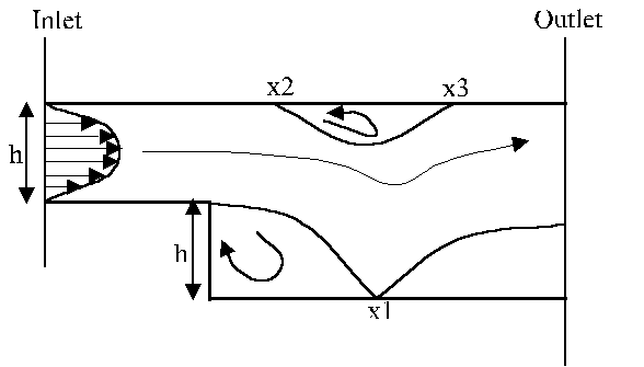

Sadly I almost wholeheartedly agreed until I remembered that there is a simple case that can prove the poor pipefitters point, flow over a backwards facing step has exactly this happening, the fluid passes over a step and then forms a weakly recirculating zone, basically heat transfers less inside this area, likewise, if you're getting flow separation, and a lot of it, it will work to insulate rather than assist in heat transfer, see the link or google, "flow over a backwards facing step" or "flow separation"
RE: Less Heat Transfer When Pumping More Hot Water Through A Coil???
And increasing flow will increase the circulation in these "dead zones" and increase heat transfer. I'm sure that with careful design you could come-up with a geometry where heat transfer went down with fluid flow, but let's stay in the real world.

Eventually with more fluid flow you would get more heat transfer and a more consistent DT along the boundary. But until then, there will be flow separation, the fluid will be plagued by recirculating zones and vortices building up and detaching from any area that has a deformity or odd geometry. IE flow detachment; on the right side of image, not that intuitive to allowing for additional heat transfer
I'll agree w/ that on the right hand side, it encourages mixing of the entire fluid stream, with fully turbulent flow there's no argument there will be more heat transfer and a fully mixed fluid. I think just past the transition point to turbulent flow, with recirculating zones and weakly recirculating and detaching vortices, it could help to create pockets of lower temperature fluid.
I would that's not that different than if there was laminar flow at that point. I don't think the issue is with specific points in the flow or exchanger behaving poorly, but rather, it's a question of the consolidated performance of the system from output to input. The transition to turbulent flow, in the totality should be an overall improvement in heat exchange.
