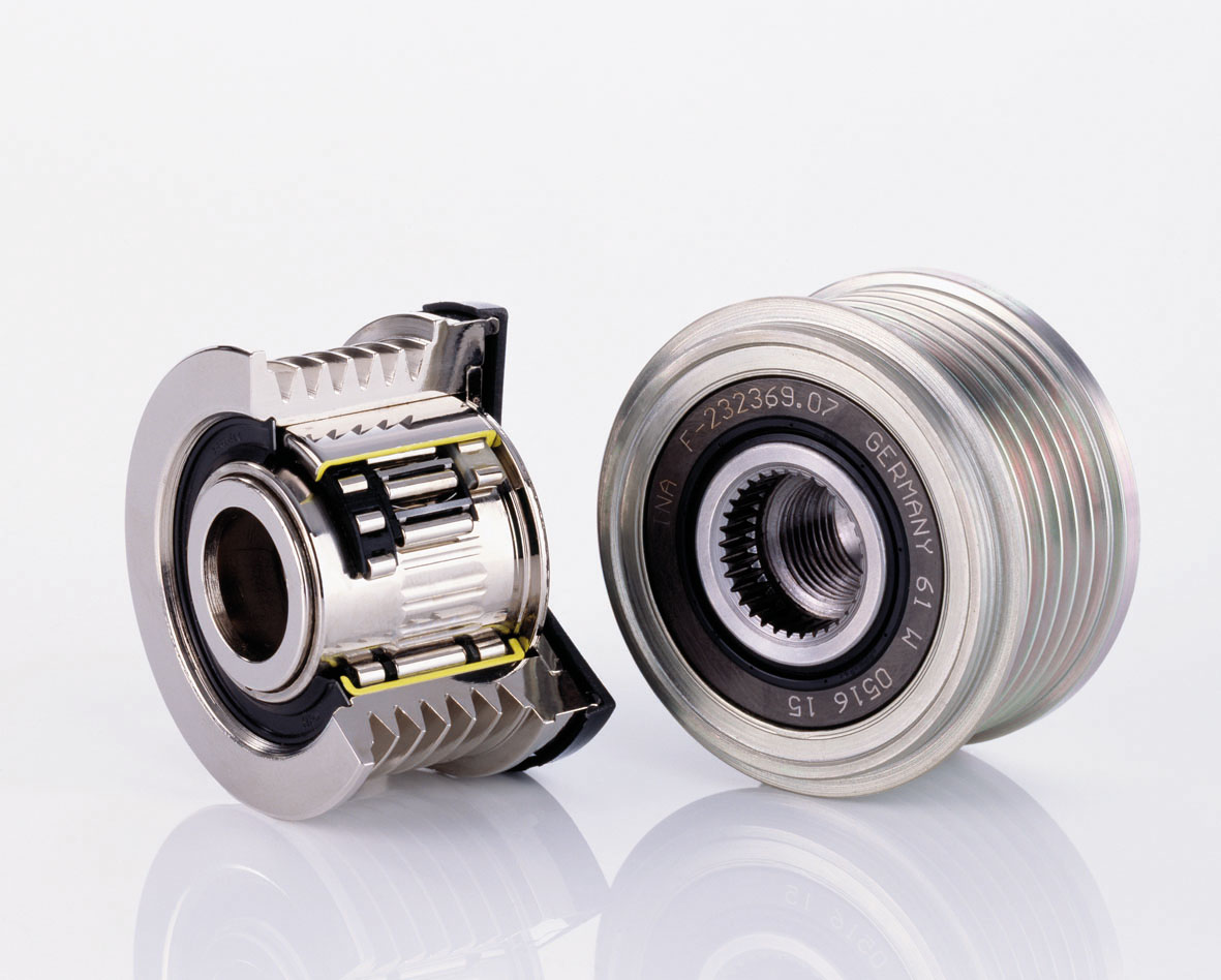

- We use this to process OAD Pulleys (example: http://www.schaeffler.com/remotemedien/media/_shar...). It iniciates with the annealing process, then it receives a phosphate coating in order to be cold formed; then the final machining of the part.
We need the long annealing cycle in order to spheroidize the carbides and homogenize the weld, to favor the cold forming process.
- The parts are actually 6 millimeters thick, but since this is a continuos process, they need to udergo the same furnace cycle as others items, which didn't showed decarburization yet (they are mostly SAE 10B22 though).
