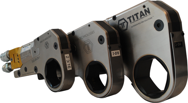

Perhaps you could use an "in-line ratchet" or "open-end ratchet" as in these pics from
Aimco http://www.aimco-solutions.com/nutrunner_types.asp
This is from www.titanoftexas.com and probably not appropriate for your use (hydraulic), but the idea of the tool is the same. With enough searching, you could find what you need I'm sure.
Better yet, describe in more detail what it is you are trying to move. There are all kinds of passive clamping devices attachable to chain lifts out on the market.
