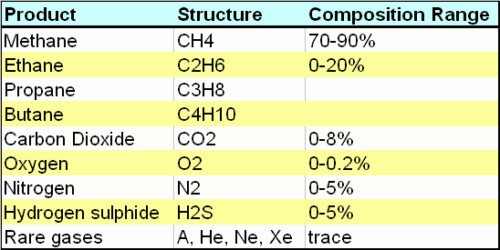

I am trying to find documentation related to API 500 in order to determine the appropriate settings for H2S and LEL monitors for an enclosed building (with fans and vents). The building handles crude oil. The API standard says that an adequately ventilated building must be capable of preventing the accumulation of explosive vapors below 25% of their LEL. What I am looking for is what gasses are likely to be present so that I can figure out what 25% would be.

4 to 6 changes of the enclosed volume of a building or room are usually adequate to keep explosive atmospheres from developing inside a natural gas transmission pipeline's compressor stations.
As far as what might be in the oil, it will usually be "natural gas" entrained in the crude which will bubble off. The problem is that natural gas can be composed of a number of gases of varying %Volumes. For the most part it will be methane, but other gases are possible. Percents by volume typically encountered are here,

Thank you. I can find the LEL for CH4.
I read that 6 room changes per hour is required for "adequate" ventilation. I am confused by the requirement for ventilation. In API 500 6.3.2.1 It is stated that adequate ventilation is the ventilation required to keep explosive vapors (CH4) at levels below 25% of their LEL. But then in 6.3.4.2 it states that at least 6 room changes per hour is required to be "adequate."
