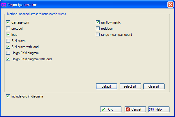

Regarding FATIGUE analysis, you need an add-on module to perform Fatigue analysis using "FEMAP with NX NASTRAN" bundle, the one I run is winLIFE, very professional, take a look:
http://www.iberisa.com/productos/winlife.htm
