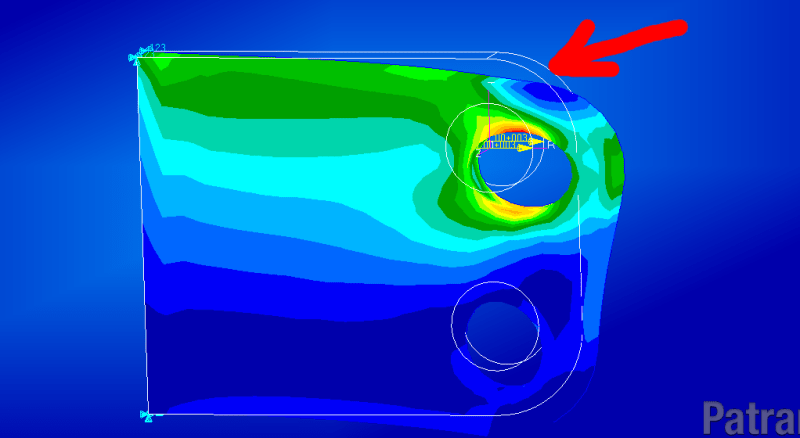

how can i hide one body from assembly in Patran ?
Thanks.
RE: Hide Body
OK, i got it - you can hide body using hide his group in tree.
But i have second problem - i'd like to hide underformed shape in results.
after uncheck Deform Atributtes --> Show Underformed still i see undeforrmed shape.
How can I fix it ?
RE: Hide Body
That doesn't look like undeformed FEA mesh. It looks like geometry objects. You can turn off the geometry objects in the Home tab.
RE: Hide Body
Thanks, I got it.
