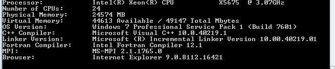

Hello guys, I am new on Abaqus.
I have to perform an analisys with DISP subroutine.
The problem I tried and tried but I am not able to make it works.
I found several guides and I followed them but it still doesn't work.
The problem is about the link between Abaqus and Fortran I guess, because when I want to check data before submit the analysis it gets me this message:
"Problem during linking - Abaqus/Standard User Subroutines. This error may be due to a mismatch in the Abaqus user subroutine arguments. These arguments sometimes change from release to release, so user subroutines used with a previous release of Abaqus may need to be adjusted."
As I already said, I followed some guide I found on the internet and the strange thing is when I want to check in the Abaqus command with "abaqus verify -user_std" I get "PASS":
so, where is the problem?
PS. I already use user subroutines succesfully with MSC.Marc.
RE: Problem with linking Abaqus and User Subroutines compiled in fortran
In addiction, typing "abaqus info=system":
It sounds odd to me. Unfortunately that error seems to be a very generic one so it may not have anything to do with the real reason you are having problems.
Have you tried to run any of the example problems in the help that use user defined subroutines? I believe there might be one or two that use a DISP. That would be a good check to see if it is a problem of running them in general or something in your setup.

Thanks. I finally make it works launching the analisys form the Abaqus command line and moving everything in the temp directory. Don't ask me why but it works now.
