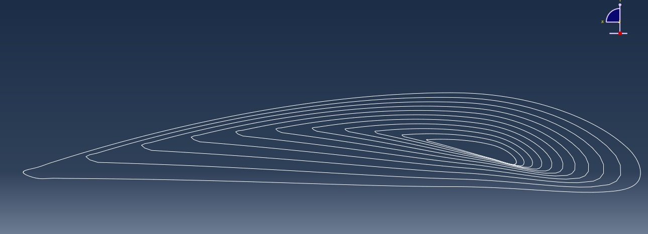

I'm having trouble drawing some wing profile on Abaqus. (note: i don't have access to other software such as Catia or Solidworks, only Abaqus 6.12.2)
I intend to draw a wing profile, with complex curvature and some twist in it.

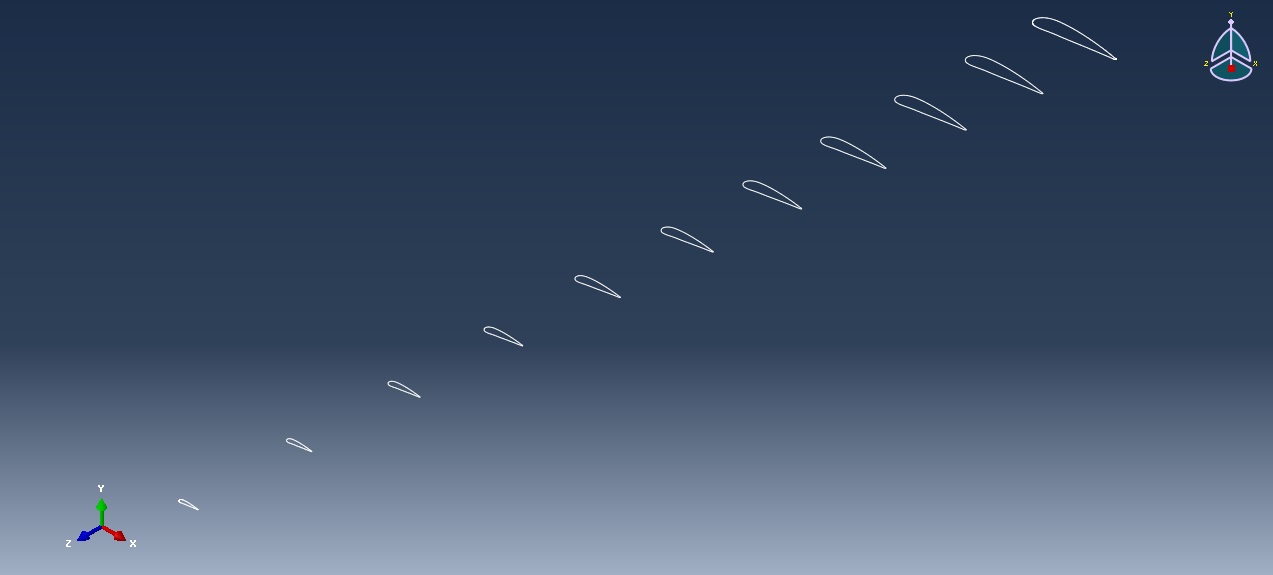

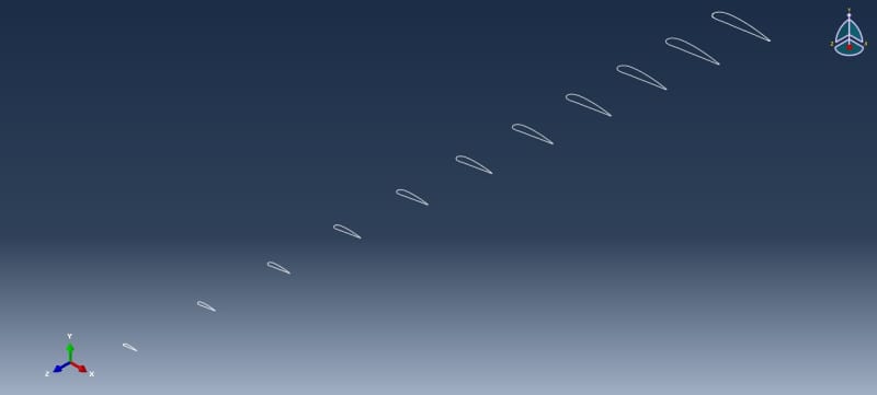

I wrote a python script to generate different section of the blade
Note that the first and last are actually shells, the inside ones are wires.
Another view

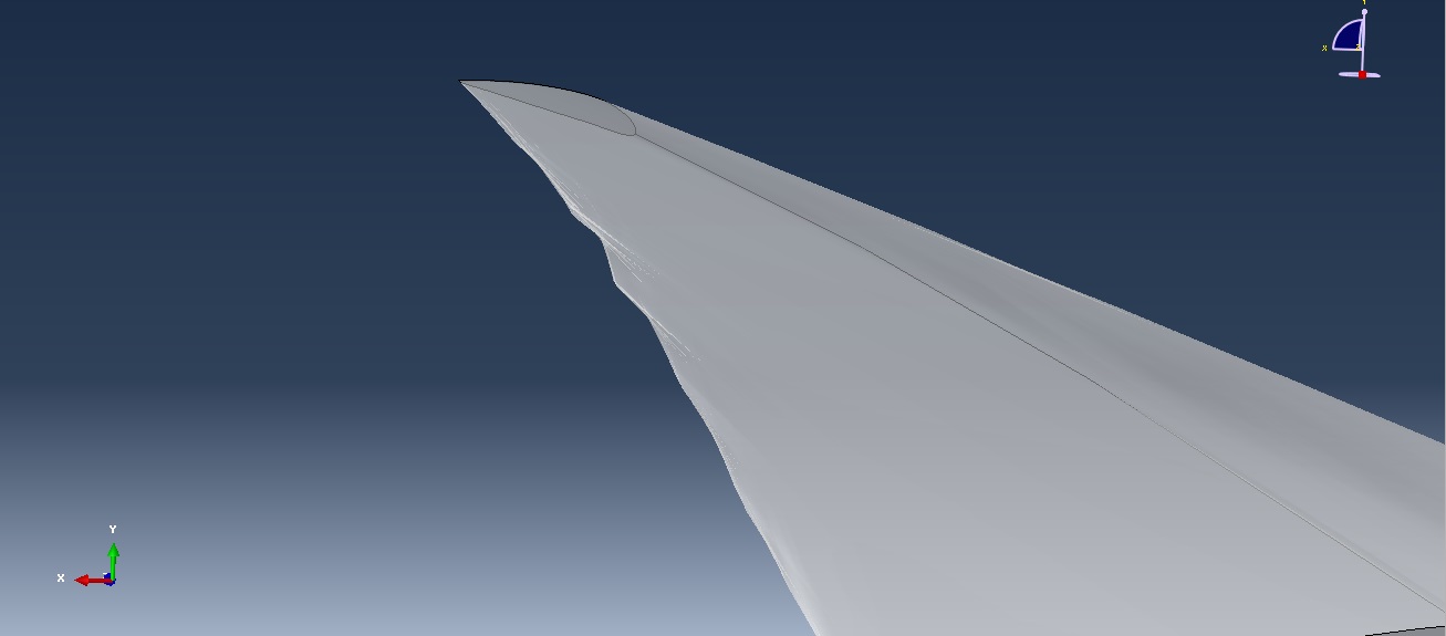

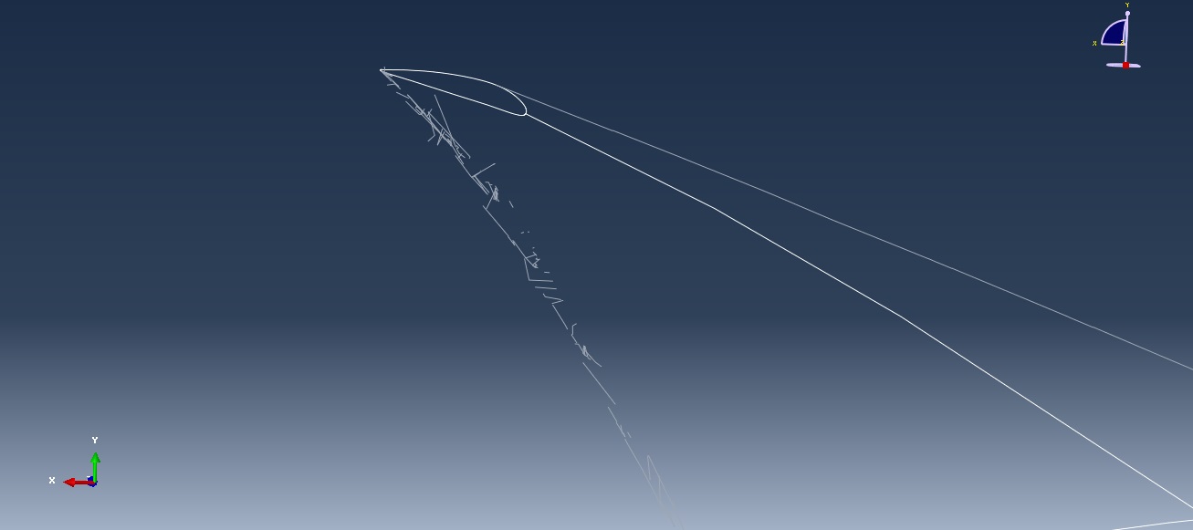

My plan was to wrap all those profiles with a loft shell. I almost get a perfect result except for some nasty wrinkles due to twisting.

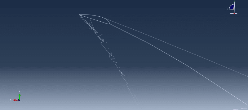

Here is what i get :
I don't get those wrinkles when i don't twist the wing.
But i really don't know how to get rid of them and obtain a smooth shell.
Should i use another method ? Or is there a more accurate tool than the "Loft" ?

I'm going to try to create two separate lofts, one for the upper surface and one for the lower surface. It might avoid this turbulence area where wrinkles appear.
I'll see how it goes smile
RE: Problem drawing a twisted wing
I tried different methods of reducing the problem down to loft sections between each strut and partitioning to obtain structured regions but the meshes produced were all bad where the elements didn't appear to follow the surfaces regardless of the element size. The problem seems to be the trailing edge with the small curvature there. Abaqus doesn't like these spline curves at all and can't seem to manage such changes in curvature. I'd try and get the original geometry and draw it out properly with defined radii. If not possible then perhaps omit the small curvature completely and simplify it by having the trailing edge just ending at a point.
