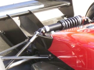

I may see this wrong, but I "think" the term fully floating spring/damper unit refers to the fact, that the spring and damper get "double actuated" [not sure if this is a good term], similar to concepts you find in some motor cycles.
In simple terms, both ends of the spring/damper move towards each other. In a conventional layout, one end would be fixed to the chassis, and only the other would move towards this "fixed" point.
Here, if we assume the body stationary in space for a moment, while the wheel providing a input, the lower wishbone has two connections. One is the lower eyelet of the spring/damper unit, and the other connects to a small pushrod which then actuates a rocker, and this rocker reverses the direction of the motion by 180º. At the other side of the rocker, the upper eyelet of the spring damper unit connects.
So the while the lower part of the spring damper is moving upwards, the upper is - not only stationary, like in a normal system - it is moving downwards, towards the lower part. So for a given input from the wheel you almost double (the true rate will depend from the rocker motion ratio) the relative movement of your damper and spring. For a given spring, you would get more force, and for a given damper more velocity, which should result in a higher force as well.
You can optimize the motion ratio for a given wheel input.
At the rocker connects another link - the "nic - link" which causes an actuation of the other sides spring/damper unit as well.
The link, has a "kink" in it, where it will deflect in relation to the force, so not all the movement get's transfered to the other sides spring and dampers.
here two photos, which should illustrate the concept quite nicely.

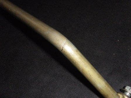

The "Kink" area is quite highly stressed, and has caused issue on some cars for some sizes of links used. see photo below.

o.k. I found another photo, which may helps to get the gist of the idea about how the "floating" spring/damper unit is working.
it is not exactly the same system as used on the Radical, but the principle is the same - IMHO

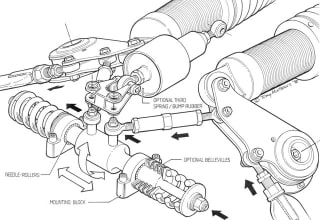

in regards to your other inquiry, about heave &/or 3rd springs, you may want to take a look at his images
and I'm sure you have come across the typical Formula Vee layout before, this is one way, to implement a "heave" spring
Please take a moment and read the content in the link below,, it's not the most technical explanation, but I think, it gives a fair idea about the different parts.
In order to try and understand the "nic-link" concept/idea/principle, pay attention to the illustration of what he calls the "roll damper" [navy blue diagonal item between the rockers] - imagine if this was not a damper, but a spring (or a spring/damper unit) connected to the shown points at the rockers.
This in a nutshell is - IMHO - the principle idea behind the concept, just the implementation is slightly different.

Couldn't you achieve this with a coil spring instead of the buckling bar? Trying to use a buckling member as a spring in this way seems grossly non-linear (even ignoring non-linearities in the linkage itself), not to mention assymetrical side to side.
You could also potentially use a coil/damper system and put damping on roll rate, which is an interesting idea, not sure if it's been done with conventional ARBs?
RE: "new" roll/sway bar concept
That bar is gonna break at the bend. It's only a matter of time.
A regular antiroll bar distributes the deflection across its entire length. That one concentrates it at the bend.
I don't see why one would do this instead of doing it the normal, proven way.
In exotic applications (F1), sure, you could put a coil-over damper between the left and right sides and have both spring-rate and damping-rate applied to roll. That's assuming you want the vehicle to have greater roll stiffness than vertical stiffness. I seem to recall those cars having very little ground clearance in the interest of aerodynamics, and that would suggest if anything, having it the other way around ...
Here's the typical f1 3rd spring/damper arrangement which gives you full vontrol over roll as a dof, that is the 3rd spring can be replaced by any combination of travel limiters, springs, dampers and inerters.
