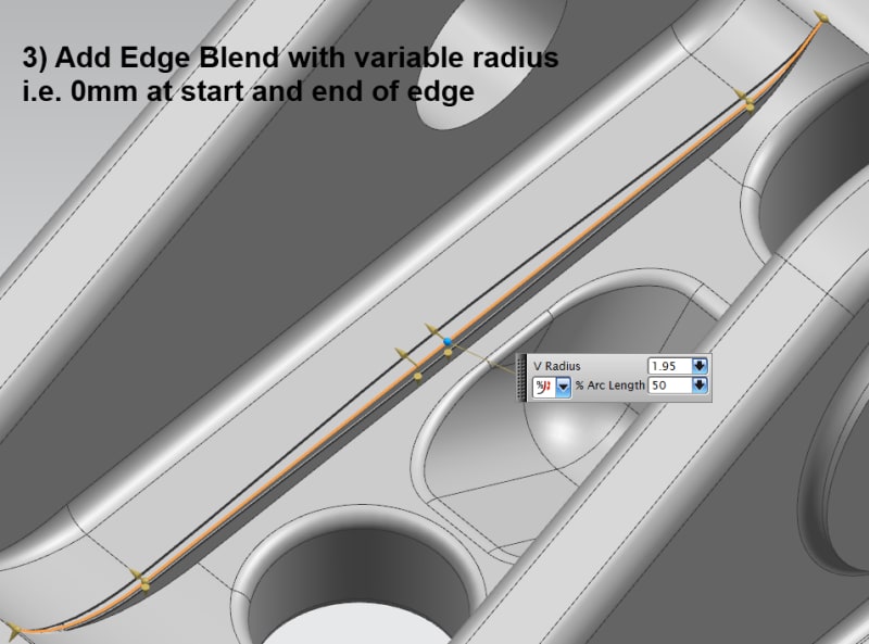

I've imported an igs from CoCreate and some surfaces aren't closed and trimmed.
I attach the origina igs and the NX8 part.
Sincerly I've played but I don't find a solution to close and solidfy the part.
Can someone try to find a solution ?
Thank you...
Using NX 8 and TC9.1

Hi all
It seems that a flat face with two blends that terminate at the same vertex did not survive the IGS conversion intact. I took a shot at rebuilding the corrupted faces, the result is not a perfect match but might be good enough depending on the intended usage of the part.

RE: Restore missing surface
I took a quick and dirty approach, a more correct way would be to use face blend and with radius method set to tangency constraint using the old blend edges as the coincident curves. But that would have required an extensive cleanup of those edge curves.
