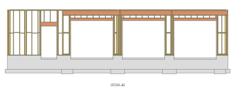

Due to the overwhelmingly positive feedback I received on my questions about the foundation/driveway question I thought I might post up one other item that has been bugging me for a while. I drew up this portal frame detail to show the nailing pattern per code so that a person with little or no construction experience could properly nail off the OSB so that it is structurally sound. However, with all those nails the whole thing looks like swiss cheese to me. Any ideas on the "correct" nailing pattern. I am trying to comply with the IRC 2012 nailing requirements for this type of portal frame.
RE: Portal Frame Nailing Patterns
The nailing is shown correctly except 7/16" shtg gets 10d not 8d, but it is lacking rebar specific to the STHD14's - are you sure you need this dtl? It is generally a high shear detail where the ratio of shear wall height to width exceeds the Code allowable of 3.5:1
I would add one more MSTC40 strap at the same side of the wall but at the right end of the shear wall to join the two discontinuous studs above and below the LVL on which the LVL bears.

Good catch MMC I missed that -
The original detail had only 2 trimmer studs and called out 2 rows (staggered) of 10d nails @ 2" o.c. (not 3") everywhere, considerably less nails because less rows of nails.
The version I have is older, and has 2 straps as MMC mentioned. I see that this new version only has 1 strap.
The new version does only show 2 trimmer studs, I think 4 is actually going to make this weaker and if you do use 4 then use only 2 rows not 4 rows of nailing.

Here are the specs:
28 ft. wide garage with 12/12 attic roof with 14 ft. span attic.
30 psf snow load
10 psf dead load
10 psf ceiling dead load
I know the dead loads are a little high but I'm trying to be conservative.
30 psf attic live load
Gives:
28ft x (30 psf + 10 psf (1.4) + 10 psf) + 14ft x 30 psf = 1,934.8 plf
The actual span of the garage door is 9 ft. but if we go center to center of the trimmer stud groups its more like 10 ft.
1,934.8 plf x 10ft = 19,348 lbs
Each side of the beam is then -> 9,674 lbs
Your telling me my capacity is 12,300 lbs so my stress index is 1.27 which is nice to have that reserve strength.

Everyone is more than welcome to take a look at the full planset I drew up here:
http://design.medeek.com/plansets/garages/GARAGE48...
I'm sure there is plenty wrong with it as it is my first "real" planset that I've put out there. I've tried to make sure everything is compliant with the IRC 2012, so look at it through those lenses. Normally, most designers don't include full framing plans with their designs but my intent with this one was to provide a planset for the lowest common denominator, basically someone with zero framing or building experience.
What I really ought to do is pay to have a structural engineer go through the entire planset and run all the calcs and tell me what needs adjustment or fixing based on my basic design parameters.

Just to complete the picture, here is the other side of the garage door shown above. Note that the second door also utilizes a portal frame:

The second detail has an approximate 70% overstress in the king stud (deflection not considered).
It also has way too many nails, hardware, and wood to make it desirable to build.

It is only a 9' garage door, and I doubt the king studs are overstressed. Especially being 2x6 studs.
I corrected medeek regarding the nailing in my posts above.
This is based on a standard IRC detail that I also use frequently, so why are you so doubtful of it?

^^It's two (2) 9' openings in second detail. That is, at a minimum... 9' plus the 2' plus the trib. at the end. At least 12'+ trib in ordinary analysis of king stud.
please do the calc on 12' trib king stud at 90 mph.. 100mph, etc.
It's not just that... but how does the load really get to the king anyway? And if those straps take it (remember leeward is also a consideration) what is the bending, shear, deflection on providing face nails normal to wind?
The detail needs some work - however the one king stud is not the only element resisting the wind bending. Read my post 11 MAR 10:54.
The problem is we don't have any rational method to prove this, by then why did the ICC come up with this standard to begin with?
Also, years ago, we demonstrated why one of 2 lightly loaded garage door trimmer studs doubled as a king stud to and existing king stud. That is, the 2 trimmers were 7' tall and the king stud was 9' tall.

You need to "mirror" the corrected version of your first (end jamb) detail so the middle jamb is symmetric.

I've sketched up Option 1 and Option 2. With both options I've added an additional king stud between the portal frames for both wind resistance and due to construction issues. If there is only one king stud it will be impossible to nail through the king stud into the LVL header for both headers. Ignore the nailing pattern, rebar, holddowns for now lets just look at the wood framing.
I'm actually thinking option 1 is simpler to frame up and unless the pony wall gets above four feet in height I don't see a reason to go to option 2.
I've had someone also ask me about mid span block. Correct me if I'm wrong but with a garage wall that is not laterally braced on the interior its studs would be more susceptible to torsional buckling especially with walls that are taller (ie. 10ft, 12ft) than your standard 8 ft. wall. Hence, the mid span blocking.

These images are a bit hard to discern. View the larger images here:
Option 1
Option 2
The original AutoCAD drawing and two options are here:
AutoCAD Drawings
You never go to Option 2 with wood...that is used occasionally in light-gage steel.
Problem is, I think you need at least 2 king studs whenever you have 2 adjacent doors. That was the gist of an opinion I got from someone else more familiar with the IRC detail. That IRC detail was intended only for situations with one door only, no other door adjacent (to prevent the pushing in or out of the wall with wind pressure in either direction).
