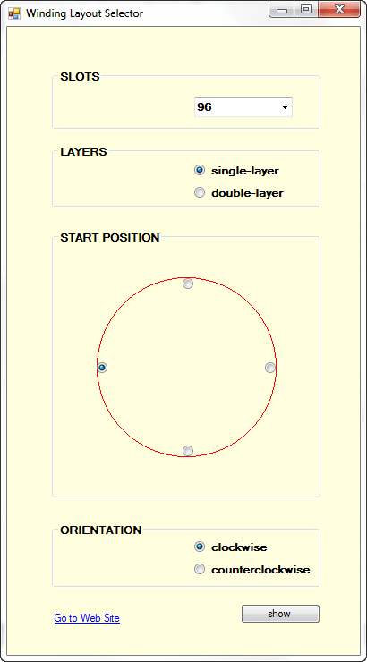

I'm preparing to record an unusual three phase stator winding.
It's about a 24 pole, 96 slots but single-layer (48 coils).
Is such a connection already known to someone?

Hello EngRepair,
Could be 16 or 32 pole motor, 48 groups, 1 coil per group for determine the connection type will be necesary more information or open the winding.For this kind of motor I will expect
8 stars or 16 stars.
Regards
Carlos
