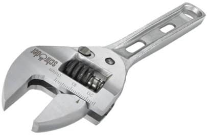

I've some problem by making a wrom wheel for a wrench.
I'm not sure of how I'm going to do it. Can somebody tell me which funktions I'm going to use.
The information:
Angel: 10 degrees
Pitch: 4 mm
Major diameter: 10 mm
Minor diameter: 14 mm

I would suggest Helix then Swept
