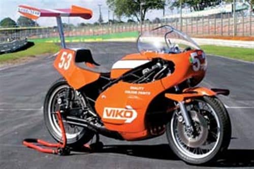

there are no rules wrt. wings or other aerodynamic devices for motorcycles mainly because there is zero use of them so I have an open book except possibly the 40" rule if the scrutineers considered a wing a part of the body work...such is not the case for cars which have many rules regarding wings etc..
This was tried in the 1970's by a NZ racer in road racing until it was banned

the kiwi rear wing is very high ... looking for clean airflow? I wonder about very low wings ... in ground effect ? (also the drag induced moment is lower)
