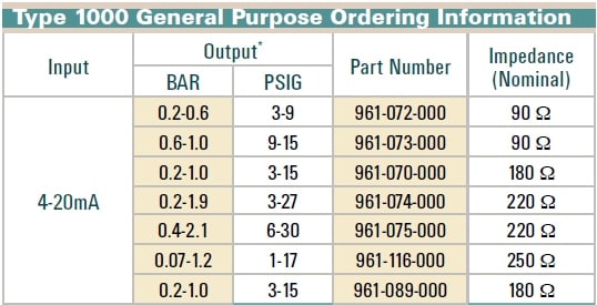

FYI, I Ran into a Bellofram 1000 I/P today. The I&M sheet says the 4-20mA input resistance is 180 ohms for the 3-15psi output range; half that, 90 ohms, if a split range 3-9 or 9-15 psi range is used:
