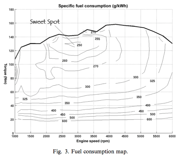

All IC engines will have an optimum efficiency RPM. If you kept the engine at this speed, you will get the most power for the smallest amount of fuel. Depending on the gearbox between the engine and the wheels, the speed can be derived. Most manual transmission cars in the EU will operate most efficiently (fuel/distance) at 40-60mph. Any less and your % of energy wasted as heat goes up and any faster and you start to see the effects of drag a lot more significantly.
RE: Mileage versus travelling Speed ?? Is there truely exists something like fuel economy Speed?
Speed requires power to overcome drag.
An engine consumes fuel according to it's BSCF and the power generated.
BSFC is lower at higher loads, so effectively as the speeds increase, the BSFC decreases.
Obviously, there is a sweet spot, and either side will see an increase in consumption, but every vehicle is different.

I had created a thread regarding BSFC and best acceleration efficiency last year. Might want to look that up. But generally best speed vs mpg is achieved at lowest possible speed in highest gear. In automatic it is the slowest speed when torque converter locks and highest gear is usually used (with exception of some modern transmission That have massive number of gears some of which are reserved for highway speeds only ie. BMW 8 speed auto). Not gonna go into technicals but higher speed means higher aero drag no matter how much more efficient your engine gets it won't make up for aero drag.
Oh and as for bsfc or optimum engine efficiency its usually ~1000rpm below peak torque on your average 4 cylinder engine with minimal manifold vacuum (vacuum induces pumping losses). It doesn't take much throttle to eliminate vacuum at low RPMs so you don't have to generally go full throttle to achieve this efficiency. Specially with modern drive by wire systems now days engines are always at peak efficiency during acceleration with minimal vacuum. This doesn't mean you should go wide open throttle though. Also modern ecus account for tip in enrichment. That is rate of change in accelerator pedal position. So be gentle and avoid lots of vacuum. Get a vacuum gauge or something like scangauge or ultra gauge to monitor your numbers.
Here is a 1.8l corolla BSFC map

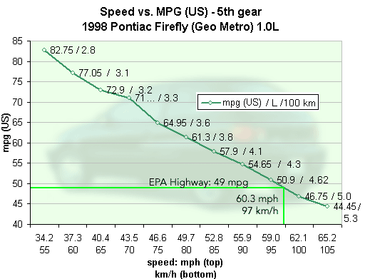

Interesting curves. The Corvette curve is what I expected to see, but the Firefly curve seems to be more common today than before, even though the Firefly is the same vintage as these:
Most of the curve(s) used for arguing going 55 mph, show a hump that peaks at ~55mph, but there seems to be a raft of curves that show at even slower speeds result in even better mileage, like:
What makes the difference?
TTFN
"What makes the difference? "
Among other things, the losses in the diff.
These have two main parts, a relatively large constant friction torque, and then a load dependent part. The upshot of this is that low speeds (hence low loads) see much greater %age driveline losses than high speeds.
Then in manual cars you have the mismatch between the possible gear ratios and the desired engine speed. In autos you have the same, slurred by the torque converter, which adds another set of losses, until you hit the lock up clutch.
The easiest case is things like the Prius where the gear ratio can be correctly adjusted to the road speed, so for a given demand power the engine can be run at its most efficient rpm.
With a typical bsfc map and typical gearing it is very hard to get near the optimum bsfc point on the map, and the Prius suffers from the same problem, the optimum bsfc is at a huge power output compared with road load. So you have to settle for trying to get near the best sfc for a given road load power.
Cheers
Greg Locock

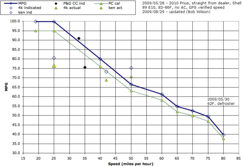

Some Prius owners have posted reviews over on Tire Rack. At least one claims to have lost several mspg switching to normal tires I was looking at. I forget which tire brand and model
Actually the Prius can operate at bsfc sweet spot while cruising on the highway at ~65mph. This translates to 15kw of power. I would worry more about factors like terrain, driving witg load and witgout bramea than operating at lowest bsfc. Read this:
http://techno-fandom.org/~hobbit/cars/sweet/refl.h...
"you're now thinking "gee, if I lock it in at 15+ kW and burn 1.3 gallons in an hour and travel 68 miles at best, that's only 52 miles per gallon!" -- while true on paper, real life driving presents enough opportunities to glide that it generally winds up a good deal higher than that."
That's an interesting graph, the subtext is that the Prius engine is relatively low powered for that size of vehicle, because any deficit in transient performance is covered by the electric motor. So when cruising it is working at a higher %age of its maximum than in a normal car.
