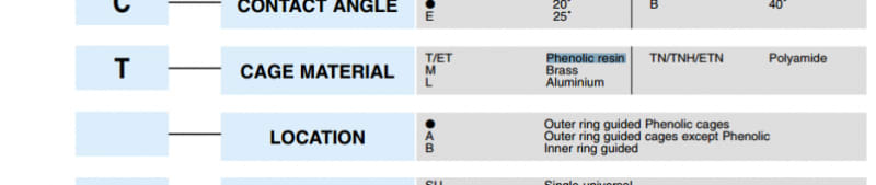

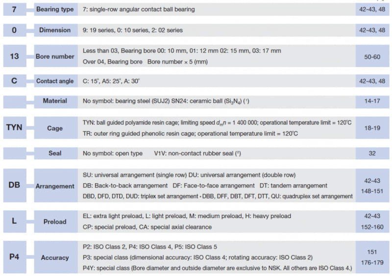

Hello elin BG,
I have found more information about symbols and letters:
70 = Bearing Series
14= Bore number
C= Contact Angle Symbol
T= Outer ring guided phenoic resin cage
SU = Arrangment symbol
L= Preload Symbol
P3= Accuracy symbol
Regards
Carlos

Thank you for your answer, I Found all the needed information. The only thing which is still unknown is the first letter "T", before 7014
RHP catalogue
NSK Catalogue
