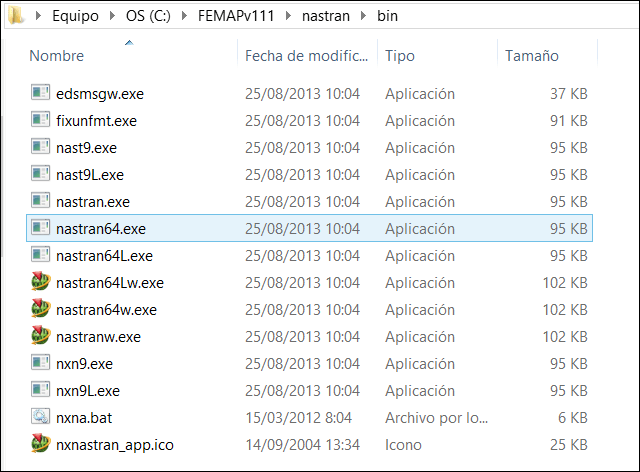

RE: NX Nastran multi cores and hyper threading
Hello!,
I forgot to comment "LP-64 vs. ILP-64" NX Nastran *.exe files, but in the above wordpress POST is well explained.
Nothing to see with multiprocessors, this is not the difference, simply NX NASTRAN LP-64 address RAM memory till 8 GB (well, exactly 7.99 GB), whereas NX NASTRAN ILP-64 has no limitation in practical real life, it address till 1 TB RAM memory.
In the following picture you have a listing of NX Nastran executables shipped with bundle "FEMAP with NX Nastran (E600)" product, you can locate the same solvers in your instalation of NX ADVANCED SIMULATION (NX13500) product under "<%UGII_BASE_DIR%\NXNASTRAN\BIN" directory. Here both "nastran.exe" and "nastran64.exe" are the "regular" NX NASTRAN LP-64 solvers, and "nastran64L.exe" is the ILP-64 solver. All the solvers are shipped not matter the "type" of NX NASTRAN licensed: NX NASTRAN DESKTOP (NXN110) or NX NASTRAN ENTERPRISE (NXN001).
Then, in case you need to solve a VERY BIG model that requires a lot of RAM memory (above 8 GB), simply select the nastran64L.exe file and provided you have enought RAM memory and hard disc space sure you will be successful!!. Usually I run "regular" NX Nastran LP-64 solver because my FE models are predominant 2-D Shell CQUAD4 4-node elements, then 8 GB RAM gives a lot!!.
