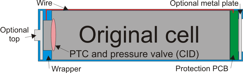

Ok, i know you guys are going to laugh at me for even attmpting to do this, but here goes:
i purchased this battery. from a us-based vendor.
http://r.ebay.com/TNTDiK
i checked the battery voltages on delivery. All were about 3.7 volts. Good sign.
i peeled away the base of one of the batteries, and indeed there was a little circuit board, with a conductor running up the side of the battery to the top.
i connected FOUR of these batteries in series. They gave 15.7 volts.
then i connected a 19 volt wall wart to the ends. after 15 minutes the batteries were warm, not hot. i disconnected, and the pack gave over 17 volts! That's too high-- a 4-pack should max at 16.8 V.
i checked each battery-- 3 batteries were under 4.2 V, but one battery measured 4.9 volts!
How could a protected battery charge to 4.9 V?

this is how they are assembled:
RE: Overcharged Protected Li-Ion?
Never seen these things before, but based on what you've described, here's a possible scenario:
1. Batteries were good. The positive terminal is connected directly to the positive of the cell, and (via the thin wire) to the protection circuit (call it PC). The negative terminal is connected to the PC. If the PC thinks things are good, it closes a switch between the negative terminal and the negative of the cell.
2. 4 batteries in series, PC is happy, looks just like 4 cells in series.
3. 19Vdc applied, cells begin charging, and by good fortune they all reach 4.2V at about the same time.
4. Voltage on cell A reaches the upper threshold and the PC opens the switch.
5. Current from voltage source falls to zero immediately, and cheap wall wart puts out a spike.
6. 20V appears across cell A, switch fuses closed and PC dies.
7. Maybe other cells disconnect successfully, but eventually 19-(3*4.2) = 6.4V appears across one cell and it over charges.
All depends on exactly how the PC works, but as mikekilroy suggests charging cells in series with uncontrolled voltage sources is problematic.

i found this "false plates without any protection function". They are identical to the plates on the bottoms of these batteries.

there's no fet or diode, only the chip, but as i explained above, the chip is fake. there is no load.
OK so you got me interested enough to look at your documentation..... interesting.... You still need to do some basic investigating with an ohmmeter Johny...
The pcb 'fake' China list is ONLY fake on top chip of a 3 chip pcb shown - fake since it simply ties B- & p- together; other two chip spots do not have the shorting run under them.
You have single and double series FET sw (8205 - see http://www.ait-ic.com/uploads/2011-01/05/_12942000...) so no clue if YOUR has the shorting runs under them or not from your pictures.
I do not think you wrote the "anatomy of a protec..." article as it shows different model pcbs and since all 4 of your batts are identical I really doubt you have different pcbs; so no idea which pcb you really have. I would not necessarily jump to the conclusion YOURs are fake....
Ohm across YOURs and see if the overcharge one isn't shorted (0 ohms) while the others are open with a batt lead off.

as i said, the pcb's on these batteries are identical to the pcb's in the listing of fake pcb's. Look at the photo. There are no components on the pcb.
yes, i don't know why these chinese producers bother, when it seems it would be about the same cost and effort to use real pcb's. But they are famous for selling fake li-ion batteries on ebay, so why not with fake pcb's?

The photo of the pcb with parts, in case you did not bother to visit the link i provided, is a generic photo from the link i provided, showing how round pcb's are connected to protected cells. I provided that to inform the poster who said he'd never heard of that kind of pcb on a cell. That is NOT a photo of my own pcb's, sorry if i did not clarify.
The photo of MY pcb is at the link i provided with the verbiage, "They are identical to the plates on the bottoms of these batteries."
