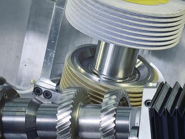

MikeHalloran,
There is an orthogonal axis thread form that mates perfectly with an external spur or helical gear. It's the grinding wheel shape used in generating type finish grinding of external spur or helical gears.
Not the same as a cylindrical worm.
