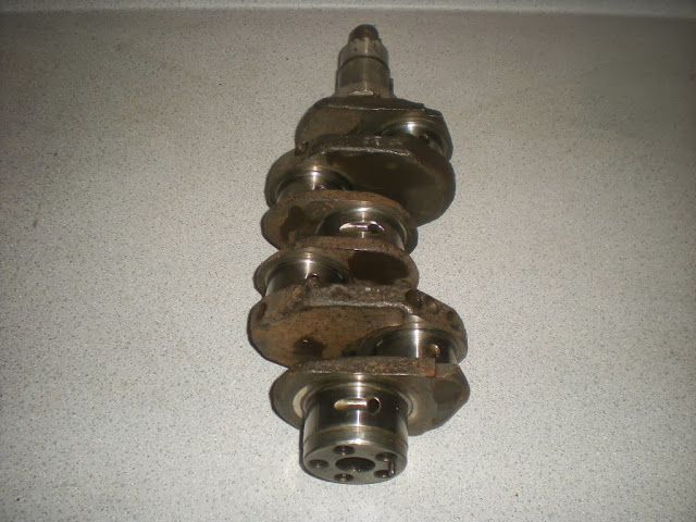

Attached is an image of the flywheel flange of the crank of an aircooled 4 cylinder Porsche. From the factory the flywheel attachment is eight 8 mm hardened dowels pressed into the crank and snugly fitted in the flywheel. (Stock aircooled V-Dubs use foour dowels) The flywheel is retained by one big bolt (Porsche and VW call it a gland nut) engaging the threads in the crank, and tightened to some hundreds of lb-ft.
After a clutch job if the bolt is not properly tightened the common result is the flywheel and crank get beat up as shown in the picture.
In the 70s and 80s we did a fair amount of repair of damaged VW and Porsche flywheels and cranks, and upgrading VWs to 8 dowels. So tightening the gland nut properly apparently was not a trivial task.
