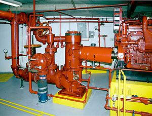

RE: Does NFPA permit Underground Conrete Fire Water tanks
I have heard the same PrakMS:
"I heard that as per NFPA the pump room should not be flooded at any point in time, so that basically means the pump room has to be above ground only".
1.Does anybody know if this point is stated in some standard as obligatory?
2. Is it allowed to have a pit as pump room beside an anderground tank with anti-flooding pump system?.
Hi and thanks to everybody.
