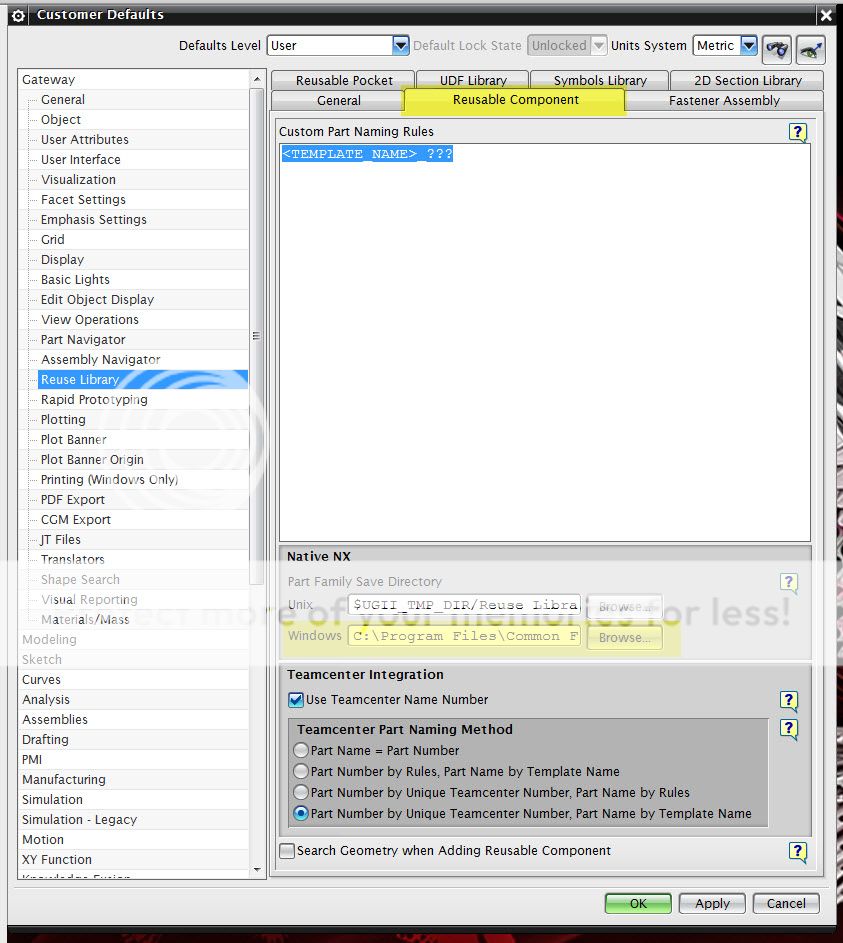

I installed a reuse library last night in NX8.5 I installed it according to the text file and video. I can see the parts (previews) but when I try to ope one I get this error.
"The family member saving directory does not exist"
Any ideas?

The attachment doesn't exist.
What version of NX?
Try go File - Utilities - Customer defaults - Gateway - Reuse library- Part name definitions - then check Part family save directory.

RE: Reuse Library Error
You need to click on the 'Reusable Component' tab (see image).
Hi Anthony,
That was it!
Many thank yous!
John
The tab "part name definitions" ( NX7.5 ) is in NX8.5 (NX8.0 ?) renamed to "reusable component".
