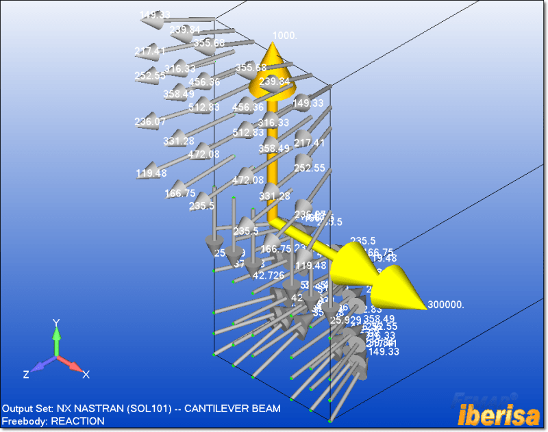

I have a doubt in the formulation of 3-D HEXA elements. I know for a fact that HEXA elements cannot take applied moments as it has only 3 translational dofs. In the case of a completely constrained cantilever beam with a point load at one end, there will be a reactive moment where it is constrained. How does the 3-D HEXA elements which cannot take moments, take this reactive moments into the picture for stress analysis? Can anyone please explain

Simply horizontal reactions in top & bottom of constrained beam end will equilibrate the moment of the load.
Here you are an example (an image is better than thousand words):
• A cantilever beam of say 20x50x300 mm is loaded in the free end with a vertical loading of FY=-1000 N.
• Vertical reaction force should be RFY=1000N, and the moment of the load will be RMX=1000x300=3e5 Nmm.
Let´s see the results:
• Here you are the resultant vonMises stress (MPa) distribution in the cantilever beam, is maximum near of the fixed end.
• And here you are the FREE BODY DIAGRAM to see the ccntribution of reaction forces in the constrained end of cantilever beam. As you can si the equilibriuem between forces & reactions is fully satisfaced, the resultant moment RMX is exactly 300e3 Nmm, and the resultant Vertical reaction force RFY=1000N, OK?.
