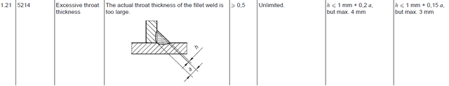

Question 8
Excessive fillet weld throat
To be based on previous discussions I understand that too large of throat thickness is mainly concerned cause of excessive heat input that can affect materials’ internal structure. If the throat thickness is exceeding the allowed limits set by standards it might point out the problem that the excessive heat input into parent material has affected the material grains. In this kind of situation grinding down the face of the fillet will bring the weld back to allowable geometrical limits but the problem of heat input still exists as the grains have already been affected. In that case in practice it would be much more important to work with welding techniques and avoid the excessive heat input rather than concentrate on grinding down fillet face to make it look visually appropriate. Am I having a right lead here ?

Few welding standards concern themselves with fillet welds that are larger than that specified by the drawing. Fillet welds that are larger than necessary is a workmanship issue that increases the cost in both time and filler metal. As the weld size is doubled, the volume is increased by the dimension of the fillet leg to the second power. In short, if you double the leg dimension, the volume is increased by a factor of four. It takes more time and more filler metal, thus increases the cost.
As for the heat input, that should not be a major issue unless the application involves operating in a low temperature environment and where notch toughness is important. There are ways to control heat input by controlling the arc voltage and amperage (minor considerations) and travel speed (major factor). The number of passes is not an issue unless the interpass temperature (temperature of the base metal adjacent to the weld)is not controlled between weld beads. In the case of austenitic stainless steels, interpass temperature control is important to mitigate the probability of sensitization and the resulting possibility of intergranular stress corrosion and possible intergranular stress corrosion cracking. In the case of carbon steel or high strength low alloy steels, the heat input is not a major concern if notch toughness is not an issue.

Be aware that the European standard for fillet welds is "across the throat" (as you have shown in the sketch) but the US standard is "leg size", so the US throat across a 90 degree fillet fillet joint would be .707 as thick as an equal European notation.
Having said that, your 50 mm fillet weld throat thickness for those 12x very short, very small ribs appears excessive: too much time, too much labor cost, too much material (excess weld filler material and gas expense) and too much heat input into the bast metal where there is no apparent reason for that much stress.
A fillet weld can never be stronger than the thinner of the two base metals being joined: Otherwise, the base metal will pull through, rather than the weld metal. Evenly loaded - and your ribs are welded on both sides - neither fillet weld should be thicker than either the casing or the rib. Even if the weld is to increase heat flow from the casing to the rib (a fin in this case) the heat transfer ability is still limited by the thickness: total cannot exceed the thickness of the rib.
