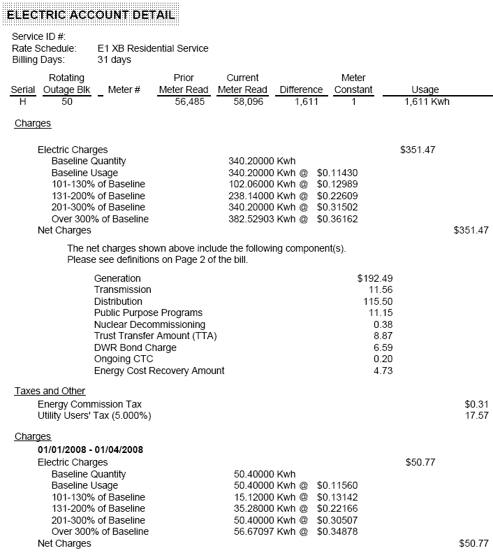

RE: Inquiry about household kWh meter
Not my bill by the way, I just pulled an image off the web. But that is my Utility, so that's what my bill looks like in terms of all the complexity and tiers (tears?). However we are also on TOU billing, so add to that the fact that the base line rates change during peak hours, 9:AM to 6:PM, so they are shown separately as well.
Each bill now takes two pages of explanation just for the electricity, then another page for the gas (combined utility, PG&E).
