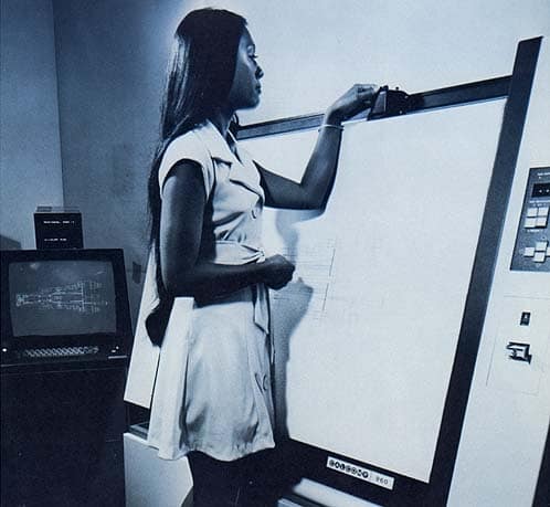

As you can probably discern from looking at the content of an NX font file, the layout of the letters date-back to the era of pen plotters. Since with any drawing at that time, the vast majority of the 'lines' being plotted were the ones which made-up the characters of the notes and dimensions, great pain was taken to design each letter such that there were a minimum number of 'pen-up' & 'pen-down' operations. In other words, the sequence of the X,Y coordinates were designed so as to draw as many of the lines that made-up a letter using a SINGLE 'pen-down -> move point-to-point-to-point -> pen-up' cycle as was possible. This, along with software which optimized the pen motions relative to the entire drawing, were key to providing not only reasonable plot times, but also to minimize the wear and tear on the pen plotters themselves, which during the early days of CAD were often the single most expensive piece of hardware needed when installing a CAD system, often exceeding even the cost of the mainframe CPU. Large flatbed plotters could cost well over $100,000 (and this was in 1970 and 1980 dollars) and even smaller belt and drum plotters could go for $50K or more, and since they were complex highspeed mechanical devices, there was always the potential of expensive maintenance and repair costs.
A typical Xynetics Flatbed Plotter:
A less-expensive belt-plotter from Calcomp (this is the type we had when I first started using CAD):
