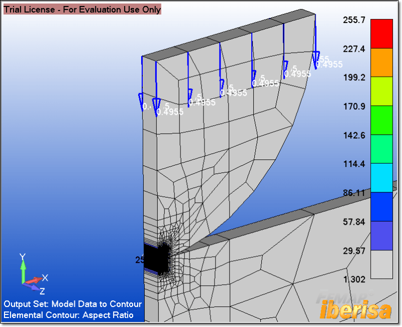

I'm carryng out the solution to the Hertz contact problem in 101 with 8 noded hex mesh.
I have uploaded my dat file as in the link below.
I have applied a load of 10.90 N to 22 nodes to make a total of 240 N.It is the normal load.
I used surface to surface contact by craeting regions of eleemnt faces as you might notice.
I applied the constraints as seen.
Howveer, my contact is not established as you can make out from contact force distribution.
Can someone please have a look? I've been struggling really.

Well, a few errors here:
1.- Your model is singular, then you will receive the error "Run Terminated Due to Excessive Pivot Ratios” because the cylinder can move freely in the space in the Z and X axis. You need to stabilize the "wheel": take advanced of double symmetry, doing TX=TY=0 in the planes of symmetry.
http://iberisa.wordpress.com/2011/02/20/mensaje-de...
2.- Your mesh is a disaster, between others violations you have ASPECT RATIO = 255.7, not all is valid in Finite Element Analysis, a minimum mesh quality is required, if not NX NASTRAN will give you error. This problem can be studied perfectly as 2-D PLANE STRAIN using 2-D QUAD elements, not need at all to use 3-D solid elements.
