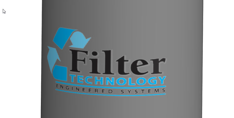

I recently added our company logo to a SolidWorks2012 assembly. In both the real view and in renders I see a white line at the top edge of the decal. File Type is PNG
I have tried the following...
- Gone into the Decal and made sure this line isn't another shade of white, I'm using the Selective Color Mask.
- Reapplied the decal in a new drawing, line still appears.
- Changed the mapping type and ratios.
- Made a new decal from a different file, line still appears.
Has anyone else had this kind of problem with decals? How can I make it go away?

Does either of your Decals (Mask) have a transparent area? If so, SW sees that as a white area and not transparent when your in your imaging software. If you could post the decals including the mask I might be able to help.

I don't have a transparent area in my decals. And I've tried using different formats other than PNG to see if any format data caused something like transparencies. BMP16, BMP256, Tiff, JPEG and PNG all give me that same line I show in the example. And when I make give the image a colored background like red, the color is there and I have to select it for removal.

Mr. Scott Baugh, CSWP thank you very much for the mask file. I've never made one before and thought I'd be able to get away with doing the selective mask. The image looks great, has a cleaner outline then before AND doesn't have that darn white line at the top.
Just showed the final render to some new shop guys and gave them a story about how we put a drop cloth down and put some well polished product on it over a weekend to take pictures. Totally believed it.

New question. Someone pointed out to me that the R at the end of Filter is grey, not dark. When I look at the mask image all the letters are white except for the R.
Am I ok to go into the mask and make the R white or will that cause issues?

Each of your letters have a shadow around which will cause the gray look. But if the whole letter is gray then there is a problem.
Do note my website - http://www.scottjbaugh.com/Tips_Tricks/Masked_Imag... - it will help you create a Mask image in the future and might help you with this issue as well.
