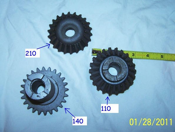

I'm working to reproduce an old bevel gear set that was originally sand cast and secondary machined. They were originally an iron gear and were quite soft. I had someone hardness test them and they came out to about a HRC 2. They are slow speed gears that are actually turned by a crank. I intend to investment cast them, but am not sure which steel material to look at and whether I should heat treat or not. Most of the investment cast gear materials are probably going to be stronger and tougher than the original, which is what I want. For purposes of quoting I need to pick one though. We're talking about a 3" dia bevel gear 22 teeth. Some of the original gears occasionally broke off a tooth or developed a lot of tooth wear all caused by worn bushing/bearing surfaces and resulting misalignment. I've got that solved. But Any suggestions for material selection and heat treat? Thanks.

tbuelna, I have tried to reproduce these gears by taking my best set and filling pits and such, and spraying with shellac. Then I had the caster use them directly in the sand mold. The parts came out with finish too coarse, too much flash and voids. I don't know of anyone using a finer grade of sand to try. If I step up to a more professional process, I'm afraid the cost vs result will go down. So I know that investment will produce the finish and accuracy I need, so I got the gears correctly modeled on the computer(which cost me). Now I need to find out how the costs for investment cast are to see if this is cost feasible. To start quoting I need to choose a material and heat treat if needed). I would like a little better wear resistance than the originals. There probably isn't a lot of cost difference between material and heat treats, but I need to nail it down for quoting.

Ted and tbuelna, thank you so much for your replies so far. I have 8 different gears, all in the same general size range, and I plan to have 100 pieces of each made if I can make the costs work. I'm not sure if they'd do 3D printer for that quantity, or if they would force me into aluminum molds for wax.
