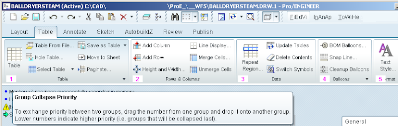

Hi.
I am making the big switch from Wildfire to Creo and am learning the whole new GUI. Concerning the ribbons (I think they're called that, anyway), I can't seem to find any info on how (if it is even possible) to keep them persistent...Using a Revolve operation as an example, every time I change one parameter like solid or surface, the ribbon collapses, So I have to keep reopening it to change another parameter, like angle or direction.
Many thanks!
RE: Tabs don't stay persistent
I found it. It can be made persistent by first being outside sketcher, right-clicking the general ribbon area and unchecking, "Minimize the ribbon".

It helps to save space when not in use. I think I have a ribbon toggle mapkey rx in addition to my R1, R2, R3, R# mapkeys that focus a specific tab which helps in Drawing environment.
The main thing that came to mind when seeing the post topic was the tab close order setting indicated by the small #s (numbers) shown on tabs during Customize Screen operation.
I'd think if you were in the midst of a feature operation relevant ribbon tabs should remain active and visible. Just Tested it, When the tab is clicked manually while Minimize is active the Tab and icons are displayed. Since Mapkeys virtually click the button somehow the same behavior doesn't occur as when done by hand. Also for long time users, some of you may recall the Mapkey Option

In answer to your question. The mapkeys are typically held in your config.pro options file in the following manner as a config option.
You can load presaved or existing options or mapkeys by simply accessing the Tools Options config (I use "0o" as the mapkey for this) then use the File Open, Browse button on the pull down showing currently loaded config.pro from the Install\text folder or your \Working_Dir or InSession.pro if neither is loaded.
Note the "Save Mapkeys" [Changed] & [All] buttons in the config dialog shown later in post, they can be used to save your old mapkeys back to your config.pro file that you use.
After loading in and applying you can then return to your previous config file by using the same method. The config dialog keeps recently used configs in the pulldown list so you can reload your config file that you save your options to.
