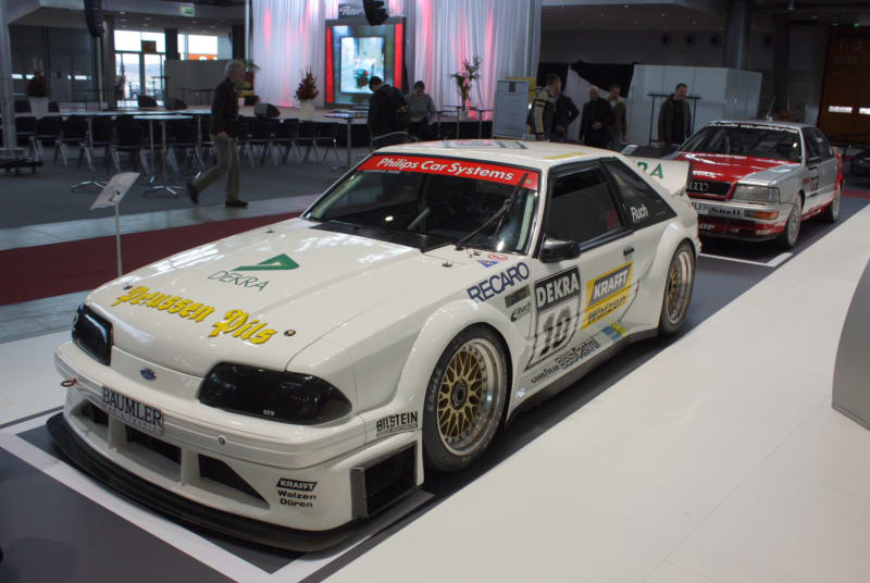

Thanks for answers,
Greg Locock - I certainly do not narrower tires !!! smile
I have not any class rules limitations
MikeHalloran - what exactly do you mean ?"fairing over each pair of tubes supporting the rear wing"
closed profile support?
rb1957- rear Wing is two element with gurney flap,
undertray is flat aluminum plate begins under transmission and ends under the rear axle axis
Radek
RE: Racing car aerodynamic optimization
What I mean is, there is some parasitic drag associated with each of the support tubes on each side of the car, because they are (apparently) round, and because there are two of them. The after tube just has to interfere with the vortex street trailing behind the forward tube.
So, fold a pizza box in half, slap it over both tubes, and staple the loose ends behind the tubes, so you end up with a sorta streamlined 'pant' over the two tubes.
At least put a streamline sleeve over each tube.

OK Mike,
I understand now dazed

Additionally, the forward tube could be smaller in diameter (and not stressed in bending) if you added a third tube extending toward the forward end of the decklid, so you end up with a structure looking like the letter 'N', and fully triangulated. Skin the whole thing of course.
Also, the secondary airfoil is not strictly a Gurney flap.
http://en.wikipedia.org/wiki/Gurney_flap
It might be more effective as a downforce device if moved up a little so it's out of the primary foil's boundary layer but still in the pressurized area.

there might be a little drag reduction fairing the front bumper edge and maybe fairing the front of the engine bay (the hood fwd edge, yes?)
Quando Omni Flunkus Moritati
rb1957 - ???? fairing the front bumper edge and maybe fairing the front of the engine bay -the hood fwd edge
I do not understand
Here small gurney flap:
front bumper ... the top edge looks pretty sharp (in your first pic) ... consider adding a radius block (to fair in the edge) ... it might reduce drag (a very little).
hood fwd edge ... again, your first pic shows the fwd edge of the hood, doesn't look smoothly faired into the front panel (in front of the radiator).
i understand two elements in the rear wing ... why not three ? (like F1)
I could replaced rear wing tubes vertical support plates
yes,
probable vibration is seen at the first image
(undertray bend before the rear wheel)
is a replaceable curtain for reducing pressure under the hood (entry restrictions cooler)
look what hood does (lift) without curtain
Of course, I can give big rear wing or 3nd wing element.
But how do you reach more downforce on the front end for aerodynymic balance?
Thanks for Your any more ideas
Downforce on the front?
Jack up the after end of the hood, like the car told you it wants, or just truncate the after end, leaving a big slot for the air to get out.
Maybe you can take it far enough to turn the hood into a huge front wing.

The vertical panels behind the rear wheels are clearly intended to help the rear undercar diffuser do its thing, by restricting flow from the side into that area, inducing better flow from under the car.
The strips at the windshield corners I'm not sure about. If there's a gap under them, they would tend to direct some of the pressurized air stacked up in front of the windshield around the A pillar in a relatively orderly manner, just as some station wagons are equipped with anti-spoilers(?) that direct the roof boundary layer down over the rear window.
... for different reasons, I think.
If there's no gap under them, I haven't a clue.
Mike Halloran
Pembroke Pines, FL, USA
I think-these cars did not have rear diffuser
panels probably restricting flow from the side into that low pressure area (diffuser effect substitute)
The strips at the windshield If you do not have the space could increase the pressure in windshield

I would like to use big end plate at front wing(splitter)

What are the speeds we are talking here?
Are there any restriction on using other car model? This one will need quite a bit of tinkering!
1. Re-profile curves over the tyres, if tyres cannot be narrower. Front tyre curve seems notorious to me -drag wise!
2. Strip out the rain-stopper strip above the windows. If you are racing, you dont need them!
3. Two front holes, if they are head lights, bring them in forward - in line with the other surfaces. Else fill them or make them thru to tyres, if you have information that ventilation is beneficial at that location.
4. Reduce/remove the hump over the hood or atleast give a cure, instead of current filleted corners.
5. Seal all gaps between surfaces, for example front guard and car body!
6. If its for racing, remove the aft door handles, cover them.
7. Bring the window glass in line with door surface. Or atleast cover the aft window with sheet metal. And remove the protruding black circle.
8. Move up the spoiler, currently its in the wake of car, not sure how effective it actually is.
9. Cover the exposed machinery on either side, below the door.
10......and lots more
What are the considerations? Time/Cost/Car Model?
Regards,
Tejas

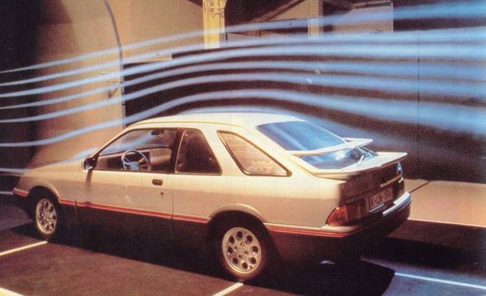

There are lot of other things, which you may probably already thinking about:
1. Change wing mirrors in style with new cars. Instead of just a rectangular piece, you can put mirrors from current car variants. Else you can get rid of wing mirrors, can try body mounted camera. You can argue F1 uses rectangular mirrors!
2. If you modify the tyre covers, you will more or less end up with something similar to Beetle car. Not sure, how beautiful it would look thou!
3. The tail end, I believe you are going to cover. Basically, Photo of Car in Wind Tunnel's Brown portion of the body, unless you have some specific reason!

Yes SAjet,
I do not need any mirrors(always only one car on track)
sorry, points 2.and 3. I do not understand well.
