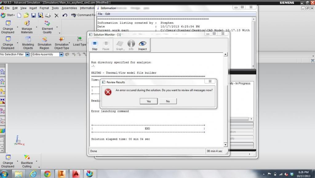

NX 8.5 Thermal Simulation Crashing
NX 8.5 Thermal Simulation Crashing
NX 8.5 Thermal Simulation Crashing
Hello Everyone,
My team and I are trying to run thermal simulations on our satellite model but the solution monitor keeps crashing. It correctly writes the elements and loads, but once the solution monitor is opens up, it crashes. The error displayed is "error loading command". I have attached a screenshot. If anyone has had any experience with this issue could you please lend a fellow engineer a hand :)?
Thank You
RE: NX 8.5 Thermal Simulation Crashing
Dear Nexus,
The screen is useless, take a look to the *.LOG file located in the same directory of the *.SIM file, open it using any text editor and you will see described the reason of the error.
Best regards,
Blas.
Blas Molero Hidalgo
Ingeniero Industrial
Director
IBERISA
48011 BILBAO (SPAIN)
WEB: http://www.iberisa.com
Blog de FEMAP & NX Nastran: http://iberisa.wordpress.com/
RE: NX 8.5 Thermal Simulation Crashing
This is what the log file says...
"Thermal/Flow Analysis
MAYA Heat Transfer Technologies Ltd.
TMG Thermal/Flow 8.5.99 Nov 27 2012
Run directory specified for analysis:
NX2TMG - Thermal/flow model file builder
Time: Fri Oct 18 15:32:11 2013
| Model Builder |
Reading model file...
Error launching command
| END |
Solution elapsed time: 00 min 23 sec"
Its not very descriptive. Is there another way to track down the source of the error?
RE: NX 8.5 Thermal Simulation Crashing
Hello!,
Send a copy of the model to SIEMENS GTAC support team, they will take care of it and will let you know what happens, and the reason of the error.
Best regards,
Blas.
Blas Molero Hidalgo
Ingeniero Industrial
Director
IBERISA
48011 BILBAO (SPAIN)
WEB: http://www.iberisa.com
Blog de FEMAP & NX Nastran: http://iberisa.wordpress.com/
