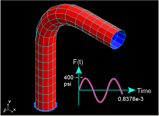

2.- If you have a harmonic dynamic excitation then a Time History Analysis, ie, a Modal Transient Dynamic Response Analysis (SOL112) is the required analysis to perform, see here a step-by-step tutorial of harmonic pressure vs. time: http://www.iberisa.com/soporte/femap/dinamico/tube...
