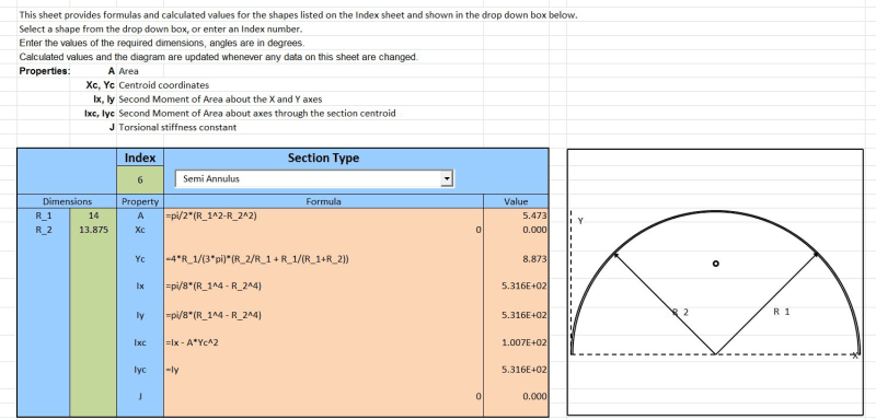

I am in search of basic formulas for determining the strong moment of inertia of an arc. I know the equatin for weak and know the integral method to determine the strong. I need a quick formula. For example, an arc of radius 14inches and thickness of 1/8" (cross section of half a pipe). The answer should be about 530in^4.
Thanks in advance.

Thanks rb for reply. I was in search of formulas without integration. I have since located formulas that return what I need. Anyone in need of formulas like this should check out "Handbook of Equations for Mass and Area Properties of Various Geometric Shapes" compiled by Jack Myers - 1962.
The answer to my question was (pi/8)*((Outer Radius)^4-(InnerRadius)^4)).
