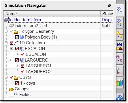

It seems that default post view settings will show Meshes listed under categories(1D, 2D etc.). Do you know where i can find the preference so it will show Mesh Collectors instead. Just naming the mesh collectors does not help. It still shows my Meshes not Collectors.
I see that you have defined ESCALON. Is that the name of the collector or the mesh beneath the collector?

Here you are the plot of Simulation Navigator in the FEM environment, where both mesh collector and mesh items were renamed. The last one are the names that you will see under POSTVIEW, allowing you to select or deselect elements from the postprocessor. NX AdvSim use to generate one mesh item for every meshing action. If you select for meshing five surfaces at the same time, then only one meshing item will appear under the Mesh collector. If you mesh one-by-one, then five items will be.
