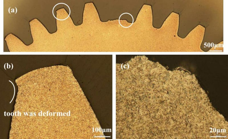

A spur gear exhibited a broken tooth during a vibration test. The vibration of the overall assembly translated to an unknown input torque on the shaft of this gear which resulted in it impacting its mating gear in both directions. The rotation of the mating gear is ultimately constrained by a non-backdrivable worm.
Material: S45C through-hardened to HRC 40
Module: 0.35mm
# Teeth: 38
Pressure Angle: 20 deg
Profile Shift: None
Mating Gear Material: S45C through-hardned to HRC 55
First, from the photos of the broken tooth below, is it a correct assumption that the failure mode was fatigue breakage at the root of the tooth?
Second, would changing the material to something like a low-carbon alloy steel and carburizing so it is hard on the surface but still ductile at its core improve its performance? Or should I simply try to increase the through-hardness of the S45C gear as much as possible?
Photo:
Cross Section:
Please let me know if there is more information needed. Thanks!

You might want to incorporate a full fillet radius in the root.
Did the deformation of the tooth occur because of some debree
in the pinion root? Nothing wrong with the hardening specs.
How many teeth in the mating pinion?

The cleanliness of the steel, grain size, etc. all contribute.
You probably already know about vacuum degassed steels giving
exceptional life. If the pinion was hobbed, I would not expect
any root problem on it. I agree too that shotpeening would
help but may not be practical on this little module system.
The fact that we cannot see any other cracks propogating makes
me wonder if there was not a default in that tooth root or
subsurface. Thanks for the excellent pictures. The teeth
to the left also looked a bit deformed.

Which load rating standard has the gear set been designed to and what are the application and safety factors that were used?
The fracture surface does not reveal any evidence of fatigue or ductile fracture.
It looks like a typical brittle fracture.
It also looks like the gears have been hard meshing.
I'm interested to know why there is heat discolouration associated with the deformation around the top lands. There's also heat discolouration in the root areas.

I can't see that there was a fundamental root stress problem with this gear. Given that the mating pinion to this 38T gear only had 9T, and there seems to some indication of abnormal contact near the remaining flank tips of this 38T gear, I'd say that the problem is more related to contact geometry.
I would agree with dinjin that both the pinion and gear would benefit from using a full radius root fillet. I would also suggest that both the gear and pinion would benefit from some tip relief. But if root fillet fatigue was the actual cause of this failure I would have expected it to occur first in the much more highly stressed 9T pinion.

Thanks for the additional photos. However, based on the photo in your OP I still think your gears had a tooth-to-tooth meshing/load share conflict. I don't think changing the heat treatment process used for the gears will resolve the issue. Instead, I would recommend modifying the profile geometry of both gears to ensure better load sharing. With a 9T pinion it is critical to apply sufficient tip relief. And as others noted, your gears might benefit from improved accuracy provided by a finish grind operation.

As a manufacturer; let me start off by saying that the gear cutting finish on those parts is atrocious!
The material that you've used normally doesn't leave tear and gouge marks as can be seen in your pictures.
Using that material normally results in a smooth and continuous surface finish, even straight off a hobbing machine.
You really need to tell your supplier that the quality isn't near good enough as it's going to affect the performance of your gear sets.
The fracture zone clearly shows the classic signs of a brittle failure. It is flat and faceted. If it were a fatigue failure, the surface would be concave and smooth.
A brittle failure suggests a sudden impact type of overload has occurred.
I don't see how increasing the hardness would help in this situation as it's an increase in ductility and toughness that is required to help reduce the risk of a similar failure occurring again.
As tbuelna suggests; with such a small pitch, tooth to tooth spacing accuracy is critical. Putting the parts through a severe process like induction hardening will add profile & geometry errors due to the quenching process.
I'm quite sure that this would affect the load sharing between successive teeth.
A much better result would be achieved if material such as 4140 is used and then GAS nitrited to an appropriate depth.
Ensure that the material is through hardened to around 32-35HRC before machining, gear cutting and then nitriding.

I am still sticking with my diagnosis of meshing interference due to profile geometry issues. First of all it takes quite a bit of fine-tuning of both gears to get a 9T pinion/38T gear to smoothly mesh.
thetank8 stated in one of his posts that the pinion had a profile shift of 1.1 which is much more than is typically recommended for 9T. The effect of excessive profile shift is evident in photos 4 & 5 (above) of the pinion where you can see knife-edging of the tooth top lands. AGMA recommends limiting profile shift such that the minimum tooth top land width is no less than 30% of the module.
In the OP, both pinion and gear materials are listed as S45C (1045 carbon steel), with the gear thru hardened (q&t)to Rc40 and the pinion thru hardened (q&t) to Rc55. Rc40 is equivalent to a TS of around 185ksi and Rc55 is equivalent to a TS of around 287ksi, so if these numbers are correct neither the pinion or gear would seem to be lacking in root tensile or flank surface bearing capability. Even given the higher strength in the pinion material, I would have expected the pinion to experience a root failure before the 38t gear did, due to the fact that the pinion was accumulating fatigue load cycles at over 4 times the rate the gear was.
