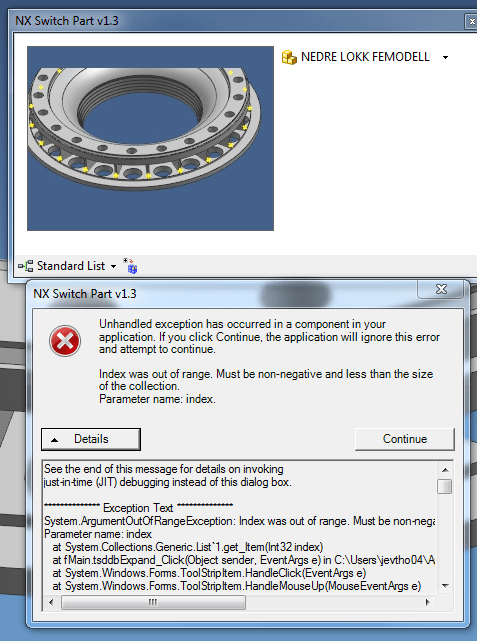

Hello all,
Switching between parts can be cumbersome and confusing with the Window menu, especially when many parts are open. Here is an alternative solution. See the attached image for a preview.
ADVANTAGES:
- the tool can be placed on a toolbar or used with mouse gestures for quick access (icon is included)
- organizes the parts into a hierarchy for better overview
- provides an image preview by moving the mouse over the parts listing
HOW TO INSTALL:
download the attached "NXSwitchPart_1_0.rar" and extract
place the dll and bmp file anywhere convenient
in NX: Customize ...> New User Command. With the new button, set Default style. Edit Action: Type: NXOpen, browse to the dll file.
Change button image > image name. browse to the bmp file.
Let me know if there are any issues.
NOTE: This tool does not alter any parts. Not tested with Teamcenter.
PREVIEW IMAGE: http://files.engineering.com/getfile.aspx?folder=2...
DLL & ICON: http://files.engineering.com/getfile.aspx?folder=8...
NX8.5 Win7SP1 64bit i7-3770K@4.3Ghz 16GB Quadro2000

Hi Simon, in your syslog it says "This assembly is built by a runtime newer than the currently loaded runtime and cannot be loaded." I suspect this means that you have on your computer a .NET framework version lower than 4.5 which causes the dll to fail to load. One solution is to download and install the 4.5 .NET framework from Microsoft. Another solution, if you have .NET framework 4.0 on your computer, to download the "NXSwitchPart.dll" file in this post which has been modified to run on the 4.0 framework. If that fails, the reason might be that you are running NX 7.5, while this tool is compiled with NX Open 8.5.
RE: Switch Part tool
@CNSZU,
thank you for this program, something should offer OOTB
the problem is taken from the syslog:
Resolve failed: NXOpen.Utilities, Version=4.0.0.0, Culture=neutral, PublicKeyToken=null
Loaded: : NXOpen.Utilities, Version=4.0.0.0, Culture=neutral, PublicKeyToken=null
Verifying C:\Downloads\NXSwitchPart.dll for NXOpen signature.
NXOpen.Utilities.MissingResourceException: Assembly has not been compiled with an NX resource bundle
bei NXOpen.Utilities.ResourceUtilities..ctor(Byte[] assemblyData)
bei NXOpen.Utilities.BaseSession.verifyAssembly(String filename, Boolean& alliance_mode, SignatureType signTypeNeeded)
Validation failed
this dll has no signature - the sign resource are also not included.
It will only run with license offer an ufunc_runtime. Newer NX Licenses don't have this option. Was a change between Nx3/4 +5.
The developer must include the signing resource into the source code and use nx_sign from the ugii folder to sign the dll after compilation.
- as developer you need a dotnet author license from siemens.
Or you would be so kind to offer the code as journal.
regards
uwam2ie
