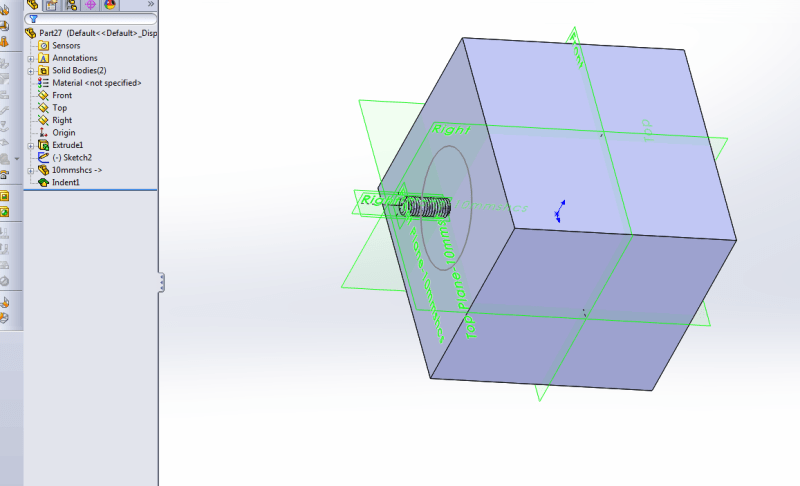

Moment,
That's where I'm at currently. Accurately placing the tool part is quite difficult. Furthermore, once I've finally got it (a shcs) in place I cannot simply select the body of the screw without windowing over it, the points and curves can only be selected independently.
Also, the tool part is retained regardless of what options I choose in the indent prompt. Is there something that I am missing there?
Prompt -->
Result-->

RE: Transitioning from NX 7.5, Advice?
If it isn't obvious the above pictures are just for example.

Tyler,
You should be using the Combine tool, not the Indent tool.
I'm not sure the Indent feature is what you want. As I and TheTick suggested I think what you want is Insert --> Feature --> Combine --> Subtract.
Then it will ask you which body is the one you want to subtract from the other and hopefully you get the result you desire.

For your particular problem of making a part with a cavity to perfectly match another part the advice above using Subtract is the way to go. You can read up on it in the SWX Help.

Combine --> Subtract is exactly what I needed.
Next time maybe I'll actually digest what I've read. conehead

Combine command at Assembly Level is called Cavity. I'm not sure if you ever used the Wave Geometry on NX but I remember it being great though not active by default.

My company does a lot of over molding so we run into this type of situation all the time. We use the Insert\Mold\Cavity command while editing the part in the final assembly. It removes the material of the parts selected that occupy the same space as the part you are editing. It also links the part to the assembly so you are not able to run a cavity command on the part in another assembly. If any of the parts that affect the "cavity" the cavity will be updated the next time you open the top level assembly. This is good and bad. It means if you use PDM and do not always have it loaded when you do it will almost always appear your local version does not match the version in the vault even if you have not changed anything. It does this because the feature is regenerated every time the assembly is opened so it appears the part has changed and you will be asked to save. The solution to this is to break the external references in the part with the Cavity. This will lock the cavity shape, but it will no longer update if you change the shape of any of the other parts.
You can also scale the cavity if needed. I am pretty sure this is the process that mold makers use when designing the mold for a injection molded or die cast part.
The icon "Indent" looks very similar to the icon for "Forming Tool". It makes me think that the material will be deformed around the reference shape. I could be biased though because I have used the Forming Tool often in another life.
