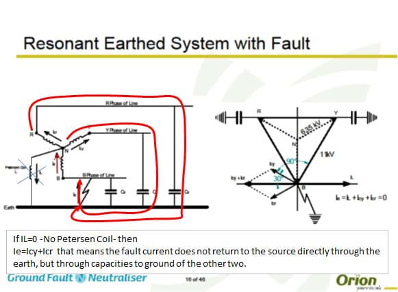

I think, on ungrounded systems, the fault current-phase-to-ground-returns to the source only through capacities of the other two healthy phases to ground.
RE: Fault Current
7anoter4; This is a special condition where a Petersen coil is installed. The Petersen coil must be tuned to the capacitive charging of the protected system line. Modern Petersen coil installations use a variable reactor and may include a control system to match the inductive reactance to the line capacitive reactance as the latter varies due to switching operations.
Bill
"Why not the best?"
Jimmy Carter
RE: Fault Current
I agree with you, waross. Simply, I employed this sketch with the Petersen Coil-but, if it can see, I deleted the coil- only to demonstrate the fact that the fault current returns to source through capacities and not through Ground. Now I see was not so clear, I guess. I did not intend to use the Petersen Coil at all.
